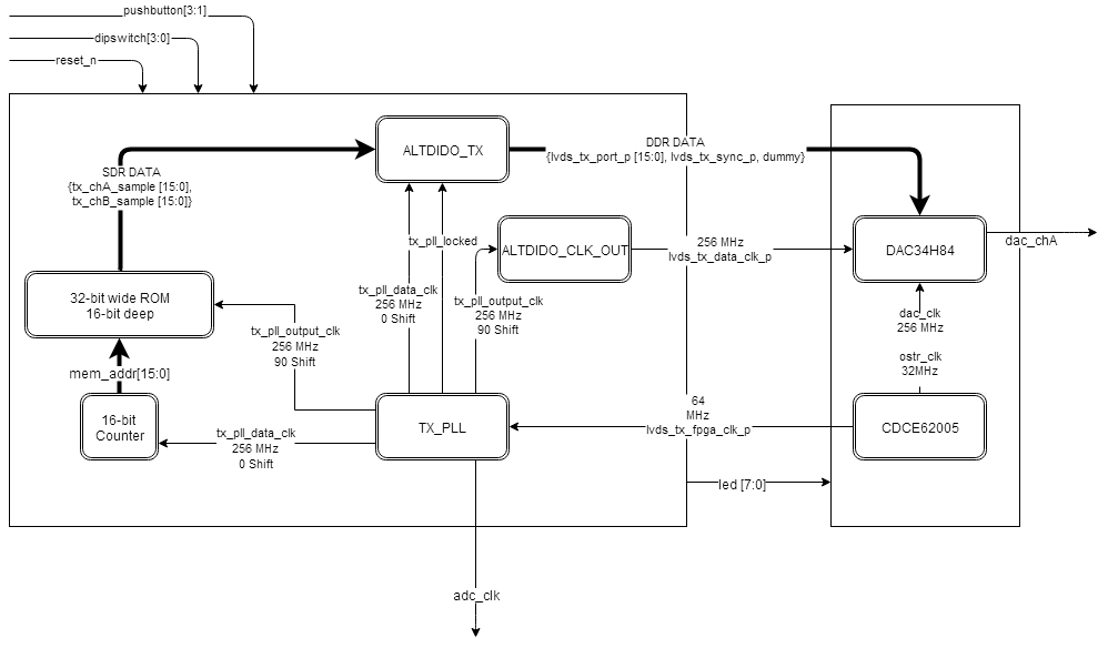

Quite a while back, I was working on a project involving the DAC34H84, the thread seen here. With the high noise in the synthesis unresolved, I moved on to troubleshoot other parts of the system.
I am trying again to get this DAC to produce a clean signal, and am still turning up with an ugly, misshaped signal. This is largely based off of the example
The function is as described below. The CDCE62005 generates a clock used to generate all other clocks on the TSW1400. A clock signal is send to a 16-bit counter, the output of which feeds to the address input of ROM. The ROM contains the signal to be created with the DAC, and is clocked 90 degrees off of the counter. The ROM is 32-bits wide, so each word contains both the channel A and channel B signals. This is fed to ALTDIDO_TX which is clocked -90 degrees out of phase of the memory. ALTDIDO_TX combines the two 16-bit SDR data streams into a single DDR 16-bit data stream..
TX_PLL is fed into ALTDIDO_CLK_OUT which create the clock corresponding to the DAC data.

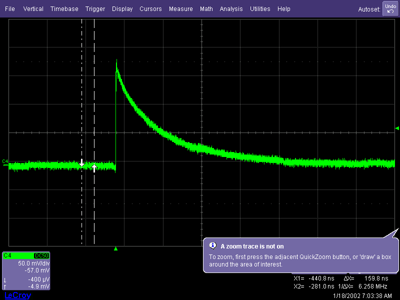

With this setup, I am getting a lot of systematic 'noise' from the DAC, similar to my problems previously, and there is huge distortion on the signal. Here is an example of a ramp signal sent to the DAC:
  • Nicholai,
    Please describe your expected waveform and the problem area. Are you expecting a nice stair case ramp from the DAC output from start to finish without any deadtime? Have you also configured the DAC output to resistor terminated to avoid a high pass filter effect?
    The ramp almost looks like a step response. Is the duration of the step response matching each sample transition and the overall sample duration? (i.e. 2^16 * sample duration).
    Also, what is the bandwidth of your scope + probe? Most of the signal distortion is caused by the signal being bandwidth limited by the measurement equipment. Please also note that in order to remove some of the transients due to the sample and hold circuit, an anti-aliasing low pass filter is needed. The DAC's output is similar to a stair-case step due to the sample and hold circuit, and will cause the output waveform not being smooth. You will need to refer to the following app note for detail:

    You mentioned that you are using the TSW1400. Is the result the same when you load the same pattern into the TSW1400 using the default HSDC PRO firmware?
    I cannot troubleshoot your FPGA firmware and can only help with your DAC setup. I suggest that you make sure the DAC is configured correctly using the HSDC PRO firmware and software before moving to your own firmware development. You may attached your DAC setup configuration and let me know your expected output waveform. I can help you verify from the DAC setup perspective.
    For all firmware development, you will have to consult with Altera support.
    -Kang
  • Thank you much for your reply, Kang.
    Yes, I am expecting a nice stair case ramp from start to finish, without deadtime. As soon as the ramp goes to zero, the next period should start and the signal goes back to the maximum. I have not configured the DAC to avoid the HPF effect. Can you point me to instructions on how to do this? This might very well be part of the issue.
    Yes, I have the signal 2^16 samples long, increasing by one every time.
    The scope is a 5 GS/s with 1 GHz backend, the cable is a high frequency cable (multi GHz)

  • Kang,
    If I wanted to remove the high pass filter effect, could I simply follow the same steps outlined here?
    e2e.ti.com/.../224608
    I would still like to measure my signal using a 50 ohm single ended scope, I just would like to remove the filtering.

  • Nicholai,
    Yes, this is a start. I also recommend you read the following app note so you understand the reason for the resistor termination.
    www.ti.com/.../slua647
    I recommend installing 50ohm near the DAC leg and use the scope's 50ohm to ground for best source/load termination.
    -Kang

  • Looking at channel D as a model, should I not be removing T1? Or am I just installing both R16 and R13 to short out the inductor, and installing a 50 ohm somewhere else? I am unsure of your instructions.
  • Nicholai,
    Let's try the following for channel D:
    1. assuming default schematic, remove R110 and R111
    2. change R37 and R39 to 25ohm.
    3. use scope probe in High Z mode, probe directly at R37 and R39. This is now in resistive termination setup.
    -Kang
  • Kang,
    Thank you for your work on this. I have made the modifications you suggested and ran the experiment (resistor termination). The results look significantly better. Here is the output of the DAC:
    As we can see, the DAC output is significantly closer to what we expected to see. There is a huge amount of noise still. Do you think this is simply because I am not currently using any anti-aliasing LPF for this measurement? Usually I'd expect more distortion, this looks like high frequency noise to me. What do you think?
