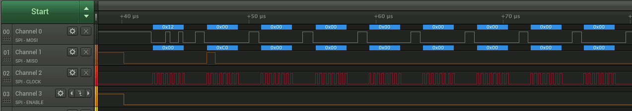

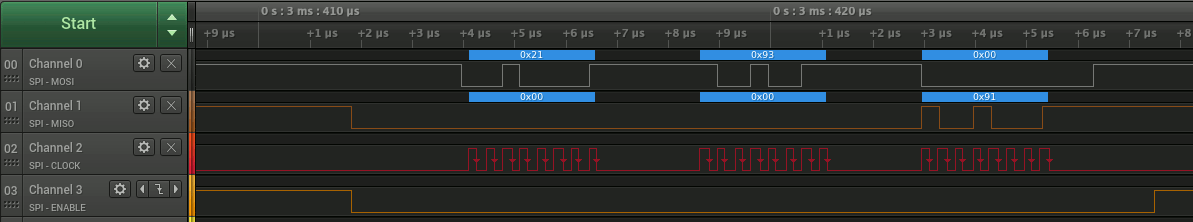

Judging by the number of requests in this thread, it might be *really* helpful to add a couple of typical SPI communication sequences to the documentation for this device. I'm pretty sure we're making a relatively trivial mistake, but there's really nothing I can find that shows a 'known good' use case.
In our case we're getting status bytes indicating that there's no problem (0xC0 00 00), but we're getting all zeros for the subsequent data.
