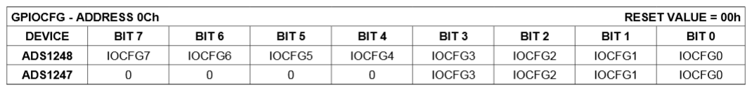

    I think that I understand. To make sure, you're saying that somehow, the GPIOCFG register (OCh) gets configured as an output and this forces more current out of one of the pins used for excitation current. The extra current out causes a large error in the measurement. By cycling the power, the error goes away because the GPIO becomes reset and correctly re-configured as the analog input.
    I would note that the ADS1247 should not read 63d (3Fh), it could read 15d (0Fh) because the first nibble should be 0. Note the register configuration from the datasheet:
    As I mentioned in my last post, the part will not just change configuration unless it receives a command to do so or there is a reset (either from the reset command, reset pin, or from a power down of the part). I think you should still read back all the registers and report back the resulting values to make sure that they are set the way you think they are. At least you will know how the part is configured when this problem is happening. Do you know what the last command issued is when this problem occurs?
