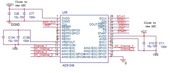

  • Hi Joseph
    Thanks for the quick response
    1. the gain is much higher then 4  (cant know for sure, i can check)
    2. the new units that i bought in 3 batches (all of them from series cxxx) are bad
    3. the data rate is good the timing is good (DRDYn goes down on time) . cant slow down
    4. I have logic i verified the signals looks good.
    5. Tuesday i will report The OFC and FSC register content.
    6. i am measuring voltage from output of Operational amplifier (-1.5 to 1.5)
    7. I am using internal reference.
    8. i used DMM to verify the voltage reference voltage and the input voltage.
    9. i also in several cases replaced the ADC with one from different series and the circuit started working.
    10.schematic:
    VSS=-2.5
    VCC=2.5
    DGND=0
    VDD1=3

  • GAIN=1
    AVDD=2.5
    AVSS=-2.5
    VCM max = +/-0.75
    -2.5+0.1+1.5/2 <+/-0.75 < 2.5-0.1-1.5/2 it on the right range

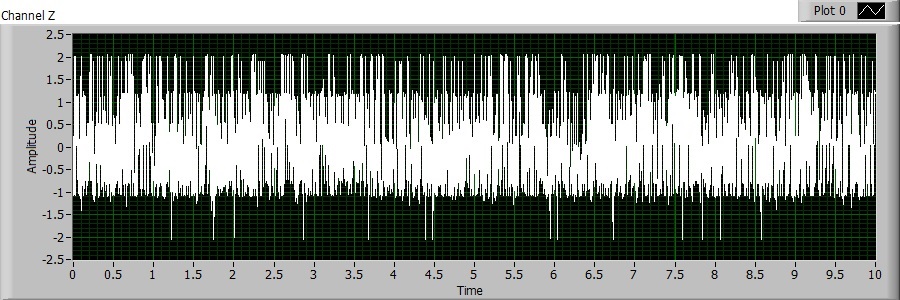

  • Hi Josef
    I have new input
    when i shorting both P and N to GND
    this is what i get (normailized to volt +/- 2.048)
    when i change to different series its showing the noise floor as expected
    Shai

    I've never seen anything quite like this where the problem is lot dependent, so I have a few more questions.
    I was going to ask what the gain error is when you have a bad measurement, but it looks like the error is mostly a random output. The graph that you provided looks a little like a digital communication error. The reason I say this is that the resulting data is a structured. It's almost like trying to read a full scale data, but the input sometimes reads full-scale, sometimes reads half-scale, sometimes reads quarter-scale etc. This looks as if the data is bit-shifting through. With the inputs at GND (which is outside the common mode input range with a single supply), you should still read something near 0. Do you have the raw data for this plot? I'd really prefer to see the digital output data instead of the converted data.
    If you do get devices that perform with real output data, what is the gain error? I'd like to know if this is really isolated to this lot and if there are ones that give you some real data.
    Also, I'd like you to confirm some of the digital timing. First check that the SCLK idles low and that the data is read in on the falling edge. This can cause some data that looks like it's bitshifted. I'd also like you to check the SCLK speed and the timing with relation to /CS. I could see that a timing error might be lot dependent, so I want to check this as well.
    The only other things that might be in error if there is some sort of violation of common-mode input range (even momentarily) that might be seen in the next reading. If the input is over-ranging the PGA, then the input might have a long recovery. If the inputs are changed and moving from channel to channel or a reference is turned on and off or switched, there might be some settling time involved. For all of the overloads, the recovery time might be lot dependent (I find this a bit unlikely, but I still want to check).
    Have you ever changed the data rate or extended the length of timing for a data read to see if it helps?

  • First i thought its gain error but  its appear to be some kind of noise outside the scale of the input.
    its not communication problem because i checked it with oscilloscope (In MSP430 UCCKPL=0 UCCKPH=0)
    i agree that it look structured so i thought maybe i didnt give enough time to settle and it didn't work
    I have degenerated the problem further more
    i took new card with machine soldered component with CSDN series device
    changed the parameters to 1000 samples per second
    START constantly up
    both p and N tied to GND
    OFFSET and GAIN register verified fine
    I verified the voltages applied are good
    and here I get on this device constant 7FFFFF
    I changed it to the old serie and it works fine.
    all the devices from CSDN and CSDL doesnt work good (i have about 30 units)
    the problem is that the project is before mass production and this is very big problem for us
    my guess is that something causing the sigma delta modulator to fail convergence.
    In the second after power up, i am getting near zero readings and after few seconds it starting the problematic behavior
    but still the thing that odd is that with old series it working and somehow something is different
    you are welcome to contact me in email.

  • The problem seen with the device is the voltage required for operation with bipolar supplies. With a low bipolar supply, the problem is in the communications between the analog and digital sections internal to the ADS1248. There are digital circuits within the analog section that still need to communicate with the digital section. Since they operate on different supplies, there are level shifters between the two sections that allow for communications. I believe that this is the problem with the data. There may be some problem with the clocking structure between the analog and digital section, or a bad modulator output. Regardless, it comes up with bad data at the output.
    For the level shifter between the analog and digital sections internal to the ADS1248, the critical parameter is the voltage step from the analog supply to the digital ground. According to simulations, there is a minimum of 1.93V required from AVDD to DGND. This accounts for variations in process and temperature (problems at cold). There may be some dependence on data rate because the modulator runs a different rates and there may be a settling time component to this problem. However for the time being, 1.93V minimum from AVDD to DGND should be the important specification to watch.
