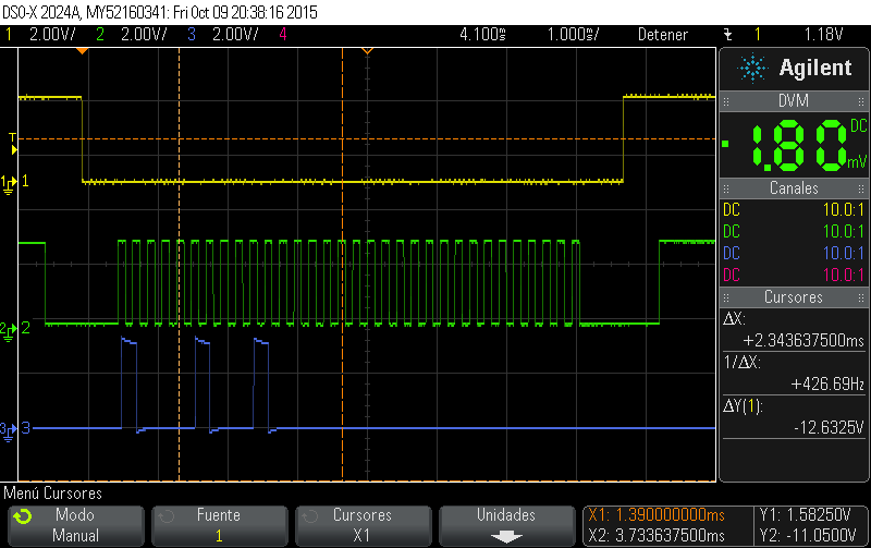

I am trying to use ADS7854 or ADS7853 for data adquisition but it doesn't seems to work. It doesn't answer anything even when I try to write in the config register. I attach an image of the command. Any idea?

    Could you please confirm whether oscilloscope channel 3 corresponds to SDI, SDO-A or SDO-B? My assumption is that channel 1 is the ~CS line and that channel 2 is the SCLK line, could you please confirm that as well?
    The best way to troubleshoot the problem would be to observe at least ~CS, SCLK, SDI and SDO-A all at once and for two consecutive frames.
    If channel 3 corresponds to SDI, then it seems to me that the screen capture corresponds to a command where you instruct the ADS7854 to put the serial interface in 32-CLK mode, use only SDO_A to put out data, put the input range as +/- VREF and use the internal reference.

    Thanks for your reply. As you told channel 3 correspondes to SDI and the command was trying to configure device as you say. SDO_A was not represented because it was unchanged with 0 level.

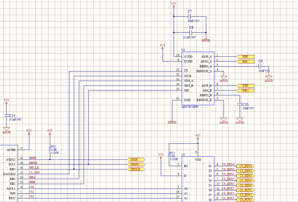

    I attach another image. I'm trying to configure the device as before, but after that I try to read configuratio nregister. Channel 1 is CS signal, Ch2 SCK, CH3 SDI and Ch4 SDO_A.
    I post an image of the schematic too`. Maybe is and hardware issue that I can't see now.
    Thanks a lot.

    The following sentence from your previous post is key “I'm trying to configure the device as before, but after that I try to read configuratio nregister.”
    If you were successful in setting the ADS7854 serial interface in 32-CLK mode and use only SDO_A to put out data, then you MUST issue at least 48 SCLK cycles to when reading and writing data. It seems to me that your read operation only contains 32 SCLK cycles.
    Two important points:
    1)      Make sure the ADS7854 serial interface is in 32-CLK, dual-SDO mode before you issue the configuration command shown on your Oct. 9th post.
    2)      Make sure you abide by the Serial Interface Timing Diagram (figure 1) of the ADS7854 datasheet.

    With regard to potential hardware issues:
    If the ideas above do not solve the issue, then it would be good to disconnect SDO_A from the SPIA line in your microcontroller just in case the micro is keeping SDO_A low. Probe with the oscilloscope (on SDO_A) after disconnecting SDO_A and see if you observe the proper data.
