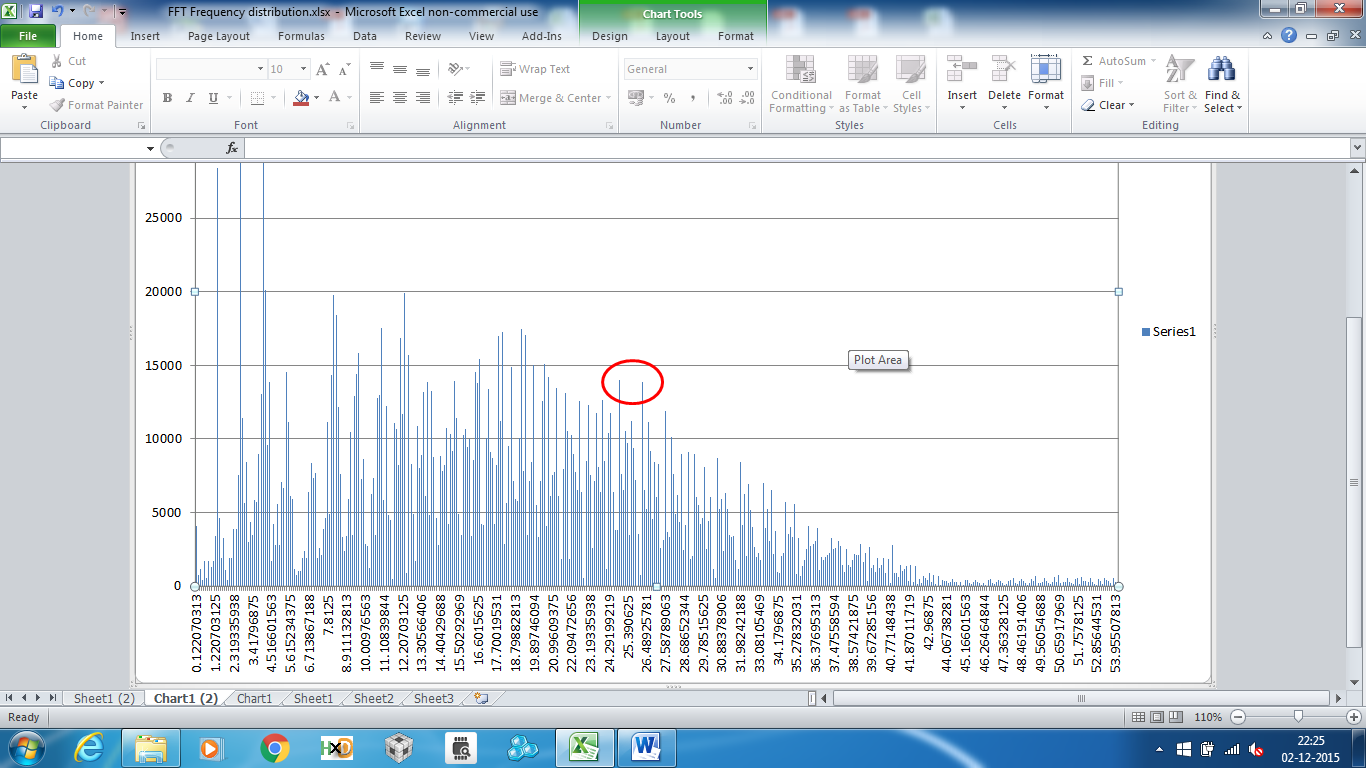

  • Brian,

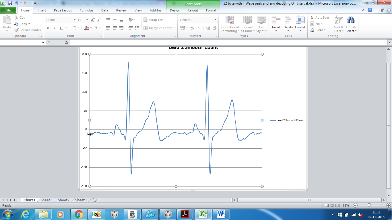

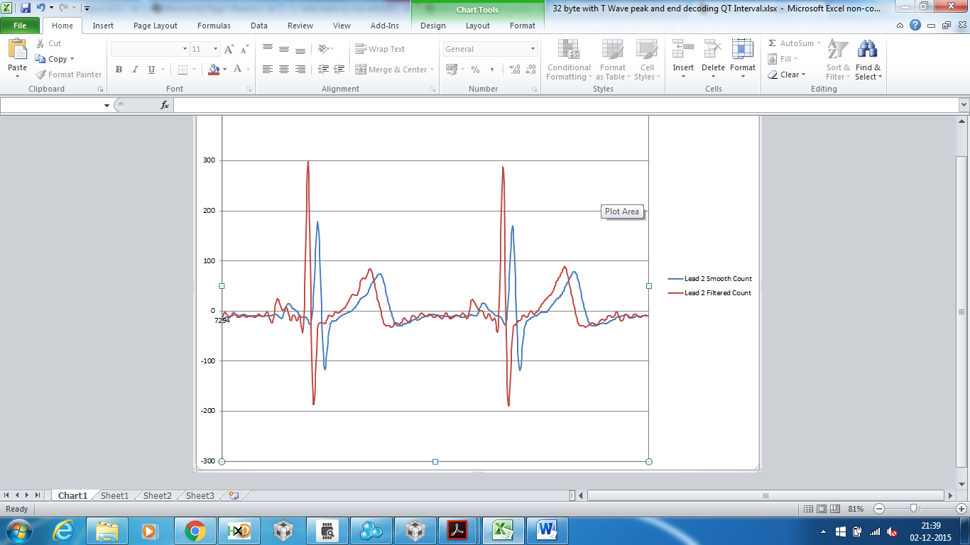

    Strangly I am seeing a lot of noise on the output. attached is the screenshot. The out put shown is cascade filtered:
    IIR - FIR (0.67 - 40 Hz) - FIR (0-20 Hz) and despite that I see this noise. Could you let me know what could be the possible reason for this. I have changed the caps on the pin 1-pin 2 and pin 7- pin 8 of the ads1292.
    Viney Chaddha
  • Hey Viney,
    It seems like there is really just one signal which is disrupting the ECG waveform. Just by examining it, can you tell at which frequency it is occuring? I'm not asking for a Fourier analysis; I just want you to estimate the time between wave troughs and divide 1 by that time.
    Brian Pisani
  • Brian,
    I did that and it around 26 Hz. the time is approx 38 mS.
    Viney Chaddha

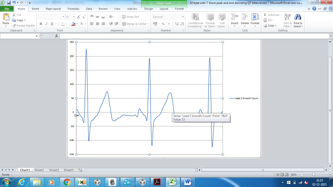

  • Brian,
    It is this 25 Hz that I was talking of earlier as well. That time I reduced the sampling rate from 500 to 125 and i got a clean signal and when I reverted back i got that back and hence I concluded it is the noise arising due to the sampling rate being high and i resorted to remove it by software filters.
    This time the filter didn't seem to remove it much though it reduced the pk-pk values.
    Another thing that surprises me is that when I took the reading without the 4.7 nF cap on the two PGAs (pin 1,2 and pin 7,8) i got quite a clean signal, the graph is attached. I am repeating it now with the caps back on them and post the results.
    Does this give you any clue on its source?
    Viney Chaddha

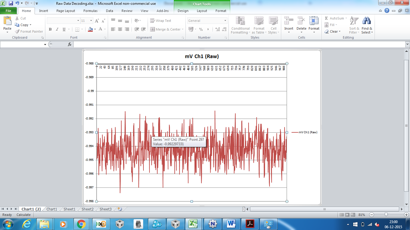

  • Brian,
    I repeated it with the caps on the pins. The 25 Hz signal seems to be absent but the cleanliness of the signal seems to have deteriorated a bit. Attached is the graph. The magnitude is small as can be seen in the other graph with the brown line which is the graph after IIR and FIR (0.67-40 Hz) and the Blue one is further filtered using FIR (0-20 Hz). I will do the FFT and send you the results of all the 3 data sets.
    Viney Chaddha

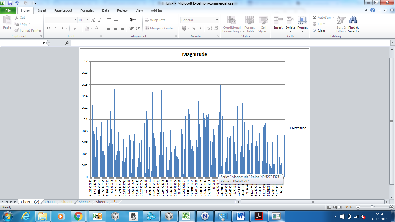

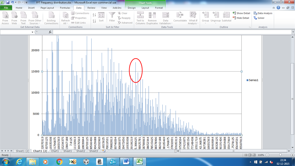

  • Brian,
    Screen shots of FFT Histograms.
    1. The FFT of the data with the caps
    2. The FFT of the data without caps
    3. The FFT of the data with the noise (the first graph that I posted)
    the noise range is 24 to 26 Hz
    The last data is of the FFT of the noisy signal for your review.
    Viney Chaddha
