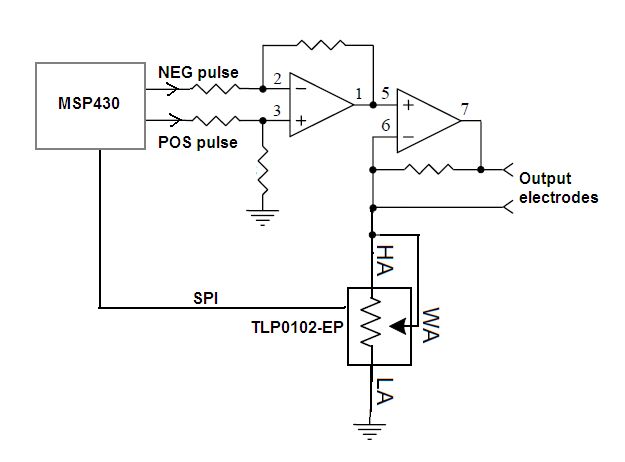

  • Dear Eugenio, thanks a lot for kind reply.
    I will check with DAC7311 for my application.
    I have also found a very simple solution (+possibility to do bipolar pulses) with OP Amp + digital potentiometer, like on attached photo below:
