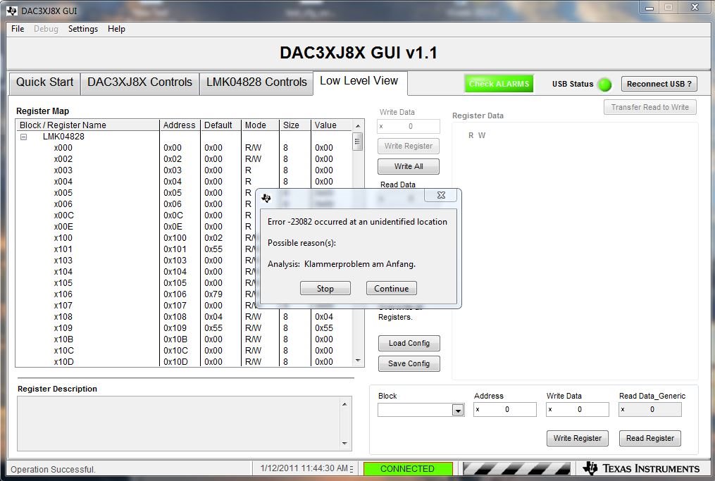

 Problem 1)
The first thing what I get when I start the TSW3XJ8X GUI or the DAC38J84EVM is this Message:
Error -23082 occurred at an unidentified location
Possible reason(s):
Analysis: Klammerproblem am Anfang.
Anyway, I can press "continue" to use the GUI…
Using “Write All” or “Read All” also leads to this error after the process has finished reading or writing all registers. Loading a config-file also fails since it does make a write all afterwards…. The register map will not be updated… Simple reading or writing one register does work.
This error does not occur when I use the ADS54J60EVM GUI…
I just focusing on the “Low Level View” because I recognized that the other tabs will not be updated after the error occurs.

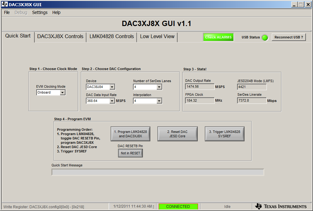

  • Hi, Martin:
    As for DAC38J84 EVM GUI, I can operate the DAC GUI well with TSW14J56 + DAC38J84EVM. Following is my snap:
    Kindly, can you do the following check?
    1. Do you use the 'DAC3xJ8x GUI v1.1' downloaded from the TI website? Or seed me a snap of the GUI you are using.
    2. I have seen that you are using TSW3xj8x GUI for DAC38J84EVM. The TSW3xj8x GUI is for TSW3XJ8X EVM. I do not have a try, but I think it maybe some problem.
    Kindly let me know your further question.
    Thanks.
    Yarn.
  • I’m using both:
    1)      TSW38J84EVM with TSW3XJ8X GUI v1.0 to evaluate Tx
    2)      DAC38J84EVM with DAC3XJ8X GUI v1.1 to evaluate DAC
    The GUI Error -23082 still exists with both EVM GUIs. This error after every “write all” or “read all” prevents the GUI from updating with the new register data. The device is correctly configured but unfortunately only the low level view is showing the correct data and not the controls view. Reading back or writing one single register does work without error and also the GUI will be updated when I set some different values within the low level view.
    Do you have an idea how I can fix the problem with this Error -23082?

  • Hi!
    The first time i see this error is after the splash screen before the GUI is visible to me.
    Afterwards i see it after every "read all" and "write all" process in the "low level view" tab and after i have pressed "Program LMK + DAC" in the "quick start" tab
    best regards!
  • Martin,
    Try this:
    When you see your installed folder for this GUI, do you see an Application.ini or 'EXE Name'.ini file there? I would suggest directing the customer to that INI file and asking him to add the line
     useLocaleDecimalPt=False
    in between some of the lines of that INI. Then, to restart the GUI. I am wondering if German language pack is causing LabVIEW to evaluate the formula nodes in that GUI improperly. This flag overrides the decimal point handling that usually differs between German language pack and US English language pack. It's just a hunch.
    The error itself relates to processing of the formula node in LabVIEW. It is likely that the programmer has configured some formulae for certain fields of the GUI as is possible using the template and this functionality is being impacted by the German language pack.
    Jim
  • Thank you. The GUI does work now!
