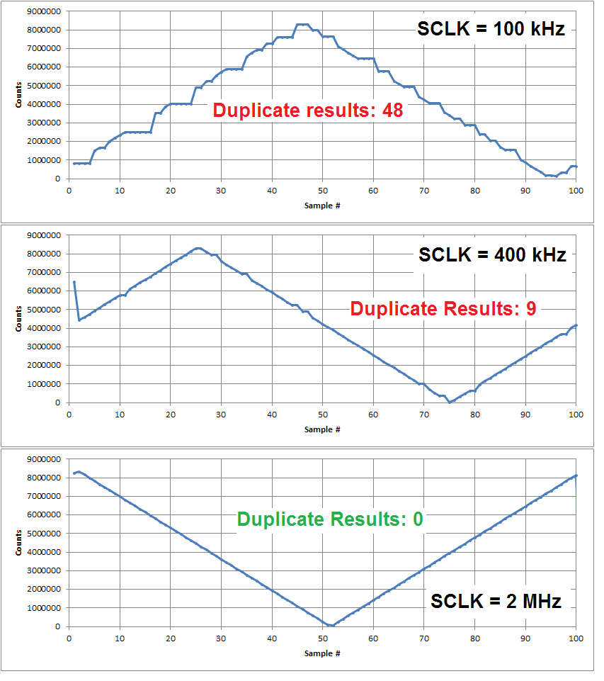

  • Chris, I'll try and post files Monday.
    Some customer feedback after my visit:
    I am 100% certain that duplicate samples are actually coming from the ADS1259.
    Here is a brief/exhaustive summary of what I have done.  I am at a dead stop and for the life of me cannot figure out what is going on with the ADS159.  I am out of scenarios to chase down.  Everything I have chased since our last meeting has turned out to be OK.  I have even modified software to take glitches in the data into consideration.
    What I need to know is what might cause this.
    I suspect it is something odd with the ADS1259 state machine. It has to be some unpublished issue or restriction of some kind.
    Is there any sort of other command that would behave similar to the RDATA that might give us a duplicate sample output somehow?  It seems very unlikely that it is a bogus START command or RREG sort of command.
    I have attached a bunch of data in a zip file.  Here is a description of each of the files.
    out.txt   -  resulting A/D data along with register setup.
    a) first 10 lines are the register values of the ADS1259 just before we begin sampling.
    b) lines 11 to 110 are the samples.
    b.1) first column is the A/D value
    b.2) second column is the software measured time (mS) between samples.
    b.3) third column, if not zero, indicates that drdy became valid within two CONFIG2 reads.
    c) Lines 111 to 126 are the overall statistical data.  Note, we are observing a 0.1Hz triangular waveform at the input.
    out.xls
    a) Illustrates a plot of the A/D data in out.txt.  Note that the sample timing seems reasonable relative to the waveform (i.e. the duplicate samples are occurring at the right timing intervals so it is highly unlikely (not possible) that two samples are being read out one right after the other or a START command is missed or anything of that sort.
    b) Note: at about -8000000 the input amplifier is railing and makes sense on the plot.
    c) You can see duplicate samples at 10, 27, 40, 80, 85 and 98.
    NOTE: the location of duplicates is never the same from run to run.  Out of 100 samples there is at least one or more duplicates that occur.

    SCRN1726.BMP - sample before sample in SCRN1725.
      page  9 of 11
    SCRN1725.BMP - sample just before duplicate sample.
      page 10 of 11
    SCRN1724.BMP - duplicate sample.  At this point scope triggering stops.
      page 11 of 11
    Zooming in on this data, the commands being sent to the ADS1259 look
    good and the data coming back, other than the duplicate sample, appear
    good too!
    NOTE: in all cases the DR=0 or 10SPS for all data.

    6. I tried issuing bogus START commands like every fifth sample attempt
    (assuming we were off by one bit shift for example) and the result was

    Here's an update on my findings so far...
    I was able to replicate the issue by applying a triangular wave and collecting data in SDATAC/pulse convert mode using the same procedure:
    	// Set START pin low
    	// Send SDATAC command
    	// Configure Register Settings {0x25,0x80,0x90,0x00,0x00,0x00,0x00,0x00,0x40}
    	// Send START Command
    	// For-loop: collect 100 samples
    		// Do-while loop: Poll for DRDY = 0 in CONFIG2 register
    		// Read data with RDATA command
    The output results varied significantly with the SCLK frequency. Here my results for three SCLK frequencies:
    I'm working with the designer to try uncover the underlying cause for this behavior, but for the meantime I know that increasing the SCLK frequency appears to resolve the issue.
    Chris

  • Hi Mike,
    I've been testing out many SPI sequences today. So far, I do NOT see the duplicate output behavior while operating in read data continuous (RDATAC) mode, when using the 100 kHz SCLK. You should be fine using the slower SCLK speed in RDATAC mode!
    However, while the RDATAC mode does not appear to have the duplicate output behavior, it does require that you monitor the /DRDY pin (not the DRDY register bit). I don't know if you're currently passing the /DRDY signal across the isolation barrier, but you'll most likely need it to use the RDATAC mode...
    Many of my test sequences have been attempting to find a way to interrupt RDATAC mode (going into SDATAC mode) to poll the DRDY register bit (to try to remove the need for passing the /DRDY signal through the isolation). In some cases, I can do this without triggering duplicate output results (by inserting certain delays into the code); however, currently I don't think this method is reliable enough to recommend. The best results have been to keep the ADS1259 in RDATAC mode.
    Note: If you operate in RDATAC mode AND pulse convert mode, you can send the START command without having to go into SDATAC mode. Therefore, the SDATAC command should only be needed to read or write to the registers.
    Chris
  • Mike,
    If you use the following procedure, it will allow for the 100 kHz SCLK frequency and for polling the DRDY register bit (so that the /DRDY signal does not need to pass through isolation:
    	// Send SDATAC command to perform WREG operation
    	// Configure ADS1259 for PULSE conversion mode {0x25,0x80,0x90,0x00,0x00,0x00,0x00,0x00,0x40}
    	// LOOP
    		// Send RDATAC command
    		// Send START command
    		// Delay ~105ms (must wait at least 40ns after /DRDY goes low and account for some clock tolerance - see Table 9)
    		// Send SDATAC command to perform RREG operation
    		// Read CONFIG2 register with RREG command
    		// Check status of DRDY bit
    		// IF (DRDY == 1)
    			// Conversion timeout error
    		// ELSE IF (DRDY == 0)
    This procedure gives you control of when conversions start; and by waiting until the conversion is sure to have finished, you will not violate the tSCDR or tDRSC timing requirements in Table 18.
    Let me know if this procedure will work for you!
    Chris
