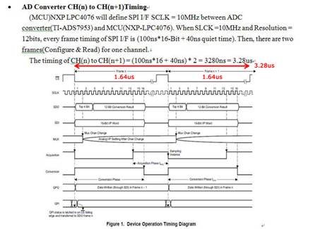

Hola,
We have a question to read the values form ADS7953.
We configured SPI clock = 10MHz, but we always need to send “three command frames” to get the values.
According to the TI’s feedback, one channel spent 3.28us at one time, but the time is 64us now.
Could you kindly share us your experience about reducing SPI I/F reading time ? Thank you.
