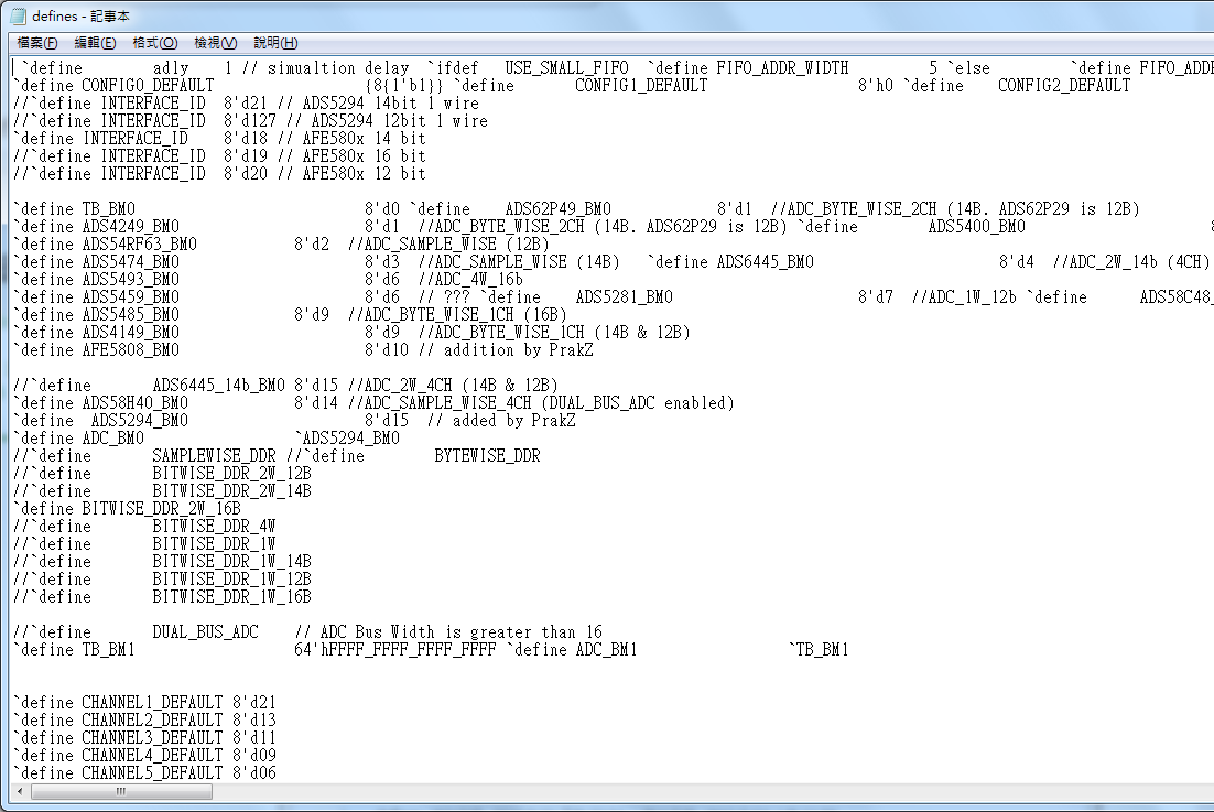

My team want to use AFE5851EVM and TSW1400EVM to implement our system.
We have tried to combine these two evaluation board,
and use the software on the TI website to capture the data. (AFE5851 and HSDC Pro)
And also have solved some problems on it.
Now we want to add some functions into the firmware for FPGA.
So we have to get the verilog source code for the AFE5851EVM.
Because we tried some other ADC boards to capture data before. (AFE5808、5809)

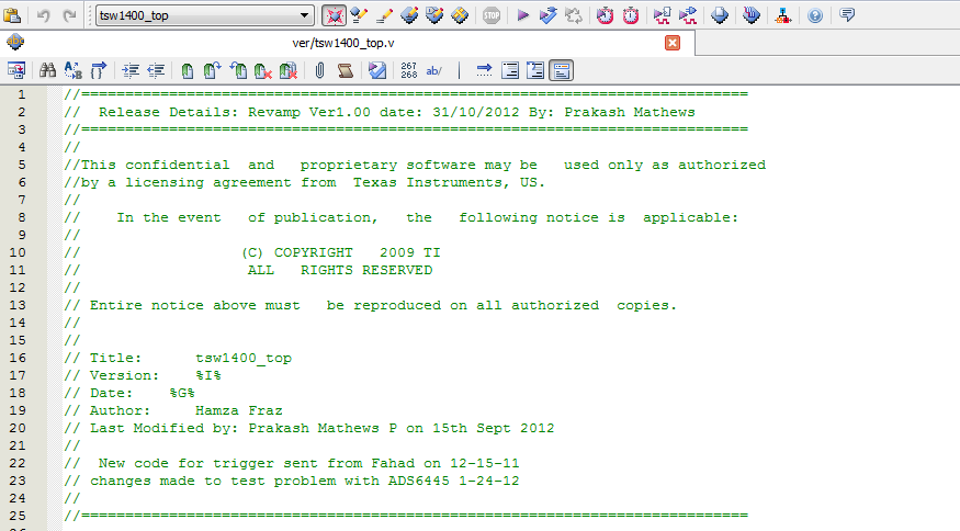

I have got a version of verilog source code.(like below picture)
But it seems not work for AFE5851.
My questions are:
  • Does the version verilog source code work for AFE5851EVM?
If it can work for AFE5851EVM, then what settings do I changes?
If it can not work for AFE5851EVM, where can I get the correct version source code?

  • Jhin,
    This code does work with the AFE5851, however this code is generic to the ADC and simply streams bits, not samples, to the memory and dll.  We configure the sample structure using a dll that talks to the configuration registers in "Dumpmem Bridge" (FIFO).  I will send another version of the code that might be more specific to the actual device.  I will send this to your email. However,  in general we can't support this code, it is just a reference.
    Chuck
