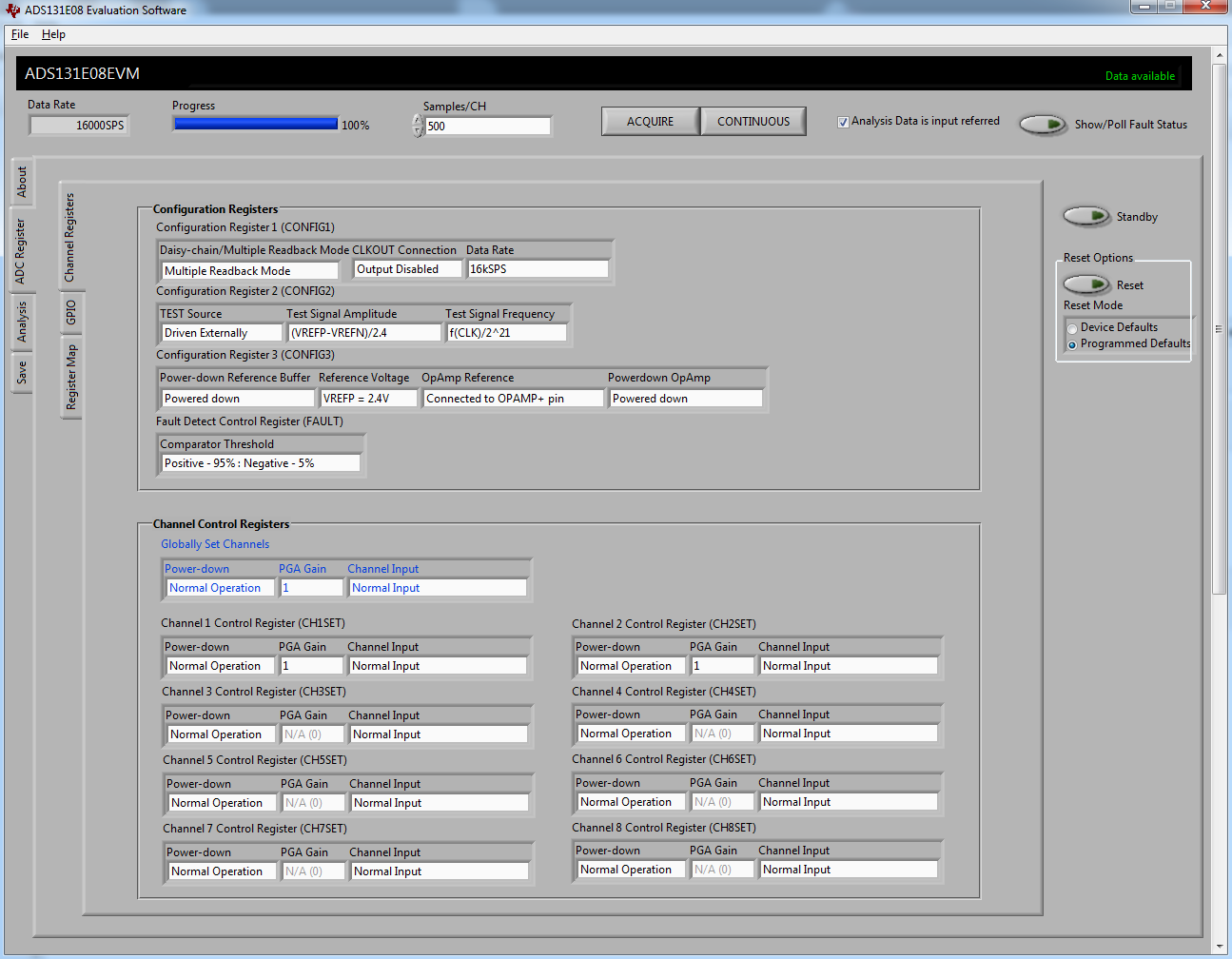

We are using the ADS131 reference board and are seeing some odd behaviour.
Input is a 400 Hz reference signal. The observed trace in the EVM software shows the signal railing to 2.4 V.
I've attached screen shots of the captured data from the EVM software, the settings of the EVM software, and a scope capture of the actual input signal, captured at the dev board terminals.
Any ideas on what we're doing wrong here?

  • Hello Mr Zarikoff -
    A quick observation from your settings screenshot? Are you setting the gain to N/A(0) or is this the software sync doing this? This is an invalid setting, so make sure you aren't selecting this gain.
  • Hi Greg,
    The N/A(0) is set on software sync, but you can see from the screenshot that channels 1 and 2 have PGA set to 1. I presume there is no requirement to set all PGA's valid, but I can report that I have tried to do this to no avail.
    I will add that the tool appears to randomly set registers values after the MMB0 is booted and loaded with FW. This is why I sent along a snapshot of the configuration, in case there was another register set that may result in a bad value.
