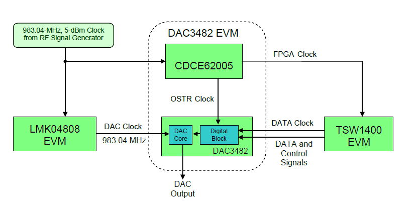

I am trying to setup CW signal of 30MHz using TSW1400 and DAC3482EVM using external DACCLK supplied by LMK04808 EVM but could not get signal out properly, I got FIFO collision alarms. Setup block diagram picture provided below:
DAC3482EVM is modified with the following:
- R154 and R155 is removed
-R124 and R125 jumper is installed
-LMK04808 EVM is programed with 983.04MHz LVPECL 1600mVpp. CLKout0/0* wired to J23 and J22 of DAC3482EVM
-DACCLK=983.04MHz supplied by LMK04808
-FPGACLK=61.44MHz supplied by SigGen CDCE62005 Y3=983.04MHz/16
-OSTR=983.04MHz/64
-Interpolation 4X
-TSW1400EVM data rate set to 245.76MHz

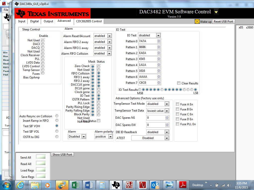

What might be wrong here and how can I correct it? The FIFO Alarm GUI picture shown below

    3> The alarm 'DACCLK gone' appears. So I wonder the DACCLK differential inputs may have some problem:
    a) The differential pair of DACCLK should be matched and closely transmitted.
    b) The DACCLK should be provided first then load DAC configure data.
    c) Try to back off LVPECL level to LVPECL(700mVpp) or LVPECL(1200mVpp) to see whether it helps. I am afraid of the DACCLK swing because the minimum single ended swing is -0.4V with a 0.2V common mode voltage.
    4> Regarding the FIFO collision alarm, try to vary FIFO deep to see whether it helps.

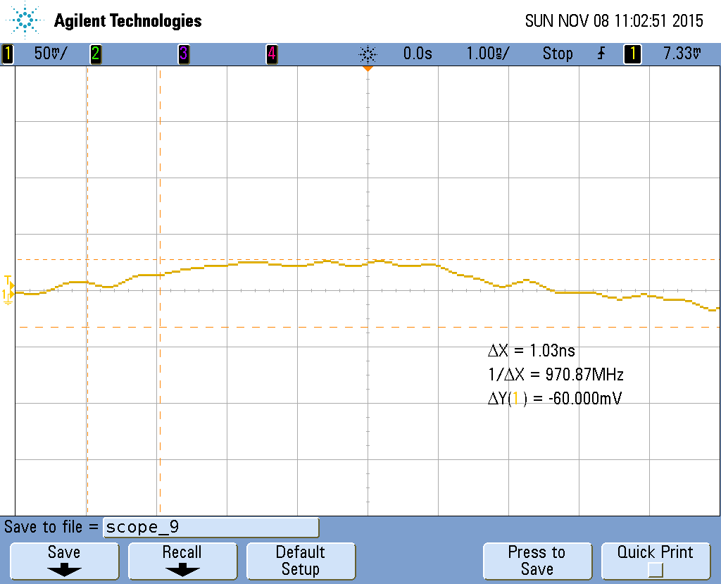

    2) Found the issue is DACCLK coming from LMK04808 does not look correct on the DAC3482EVM , it appear to be impedance issues of the transmission line, I don't fully understand:
    a) Image 1 shows setup LMK04808 output to LVPECL 2000mV, probe right at the LMK04808 EVM CLKout0 SMA output connector. Correct clk frequency is observed= 983.04MHz at 60mV pk-pk, this output is AC coupled signal with DC bias =0V
    b)Image 2 shows probe this DACCLK signal right at the J22 connector at the DAC3482 EVM. Noticed the CLK signal is almost gone, instead the tiny clk signal is riding on some slower AC signal!
    c)Image 3 shows probe the DAC3482 EVM CDCE62005 DACCLK signal output, looks to me the bias DC voltage is 1.9V, I use AC couple on the probe.
    d)Image 4 shows my eval board setup and cable (SMA to SMB) from LMK04808 to DAC3482 EVM
    e) If I disconnect the SMA to SMB cable, then CLK signal on SMB side looks correct. It looks like impedance loading issue between the two eval board makes the CLK signal to be distorted when cables are connected.
