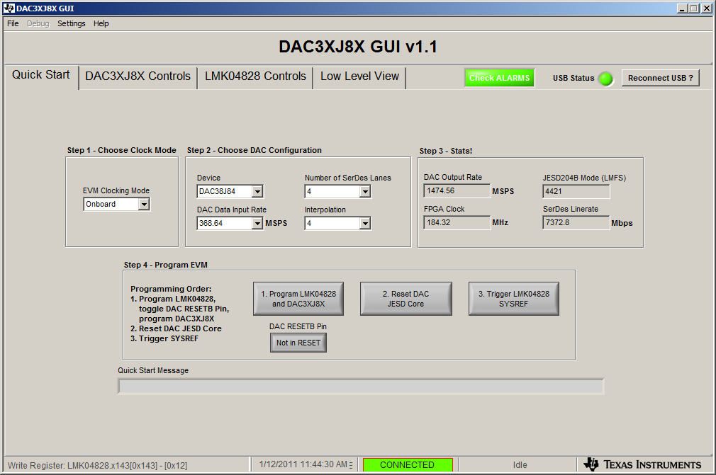

I am trying to establish the JESD link between Dac39J82 and FPGA. I am following the Initialization set up sequence at page 132 of the DAC39J82 specs.
After I feed in a single Sysref pulse, (and I did make sure this pulse happened by monitoring it on the oscilloscope), I did not see the Sync signal come out from the SYNCB pin of the Dac. I have been stuck for a couple of days. Can anybody throw some lights on this?

    1> For the polarity of SYNCB, when the DAC38J84 is requesting sync, the SYNCB (LVDS logic) is set to logic LOW. The FPGA then will send the K28.5 characters. When CGS is established, then the SYNCB will rise to LVDS logic HIGH. Please kindly check the SYNCB signal is High ->Low  in your case?
    2> By default, the GUI will set JESD204B to skip one SYSREF pulse than use the next pulse as below:
    So, if you send only one SYSREF pulse, it is not sufficient, because only the clock divider is synced as below:
    3> The reason that you may use multiple pulse is that in the DAC logic, there is a clock divider circuit that provides all the divided down clocks to the digital logics and all the JESD logics. The clock divider is initialized by the SYSREF upon the first pulse. We thus set a delay on the JESD logics to use the next pulse of SYSREF to ensure the divided down clocks are initialized properly prior to the JESD link sync.
    4> Once again, upon powering up of the DAC38J84, the SYNCB LVDS logic will output logic HIGH. After the programming of registers, the initialization of JESD block, and triggering of the SYSREF, the SYNCB LVDS logic will output logic LOW to request JESD synchronization/CGS stage from the FPGA. If SYNCB stays low, it means that your CGS stage haven't been passed.
    5> You may try the SYSREF with several pulses, normally, we use 8 SYSREF pulses.
    6> For the startup sequence, please kindly refer to the attachment:
    8030.DAC38J84 Start-up Sequence.docx
    Thanks a lot!
    Yarn.

  • Hi,Hao:
    I have checked  your configuration procedure, and may find these points from my sight of view:
    1>when pulsed SYSREF is used, make sure SYSREF is DC coupled.
    2>SLEEP pin should be low, because by default config 35 is 0xFFFF, which means SLEEP pin directly routed to various blocks of DAC.
    3>If JTAG is not used, make sure TRSTB pin is low.
    4>Regarding register 0x61, if only link0 is used, 0x001 or 0x211 is suggested, by default, we set it to 0x211.
    5>For the BID and DID value you mentioned, I tried with my setup and get all zeros. I think you can ignore it as datasheet says.
    6>To test the DAC, you can refer to ATEST pin and try register config27.
    7>I think your setting of 'SYSREF arming' and 'JESD block reset' is right. Firstly,   JESD block should be reset and set to INIT_STATE. Then using the second SYSREF pulse to sync clock divider and using the third SYSREF pulse to sync JESD block. After JESD block is synced, SYNC is pulled low(I probed it in my setup). Then JESD link begin the CGS stage.
    8>I have attached my setup snap and configuration file for your information. Hopes it can help you.
