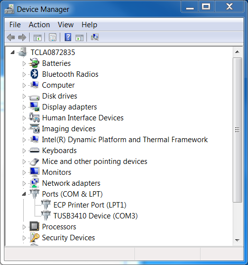

    First you find the EVM on the com port. Here I've opened up the device manager and found the TUSB3410 device on COM3. The COM port will depend on your system and you'll need to open the device manager to find which port it is found on:

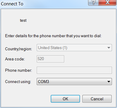

    I've gotten hyperterm (which I think I was able to get for free) and opened a new connection which I've called test. Then I connect to COM3.
    For communciations I set the baud rate to 230400, 8 data bits, no parity, 1 stop bit, and set the flow control to none.

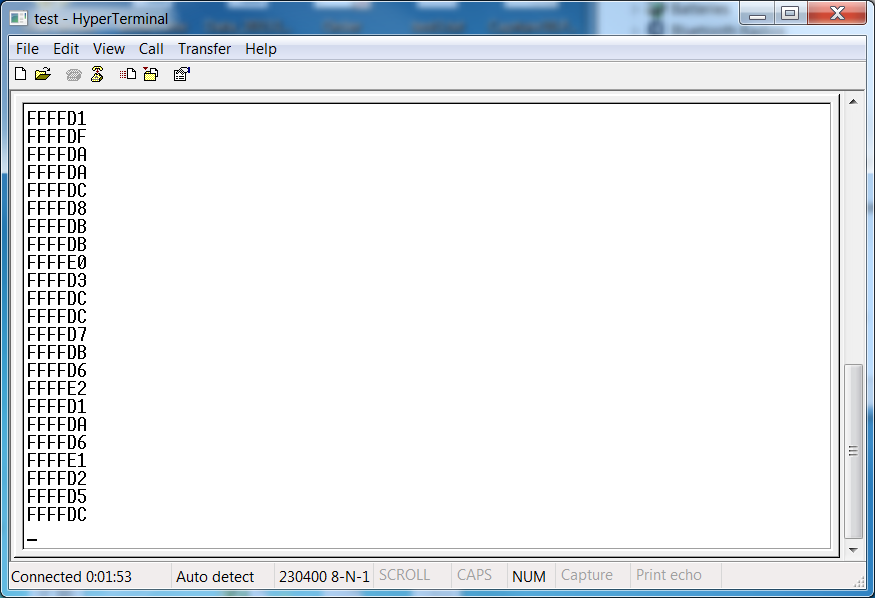

    After that I can send commands to the EVM. Start with "q" which lists the setting of the device. I also set the data rate to the lowest setting and tie the inputs together on AIN0. "s" will start the stream of data and space bar will allow you to stop.
    Then I go to the Transfer tab and select Capture Text which will allow you to send anything coming over the line to a text file. There might be some issues with the fact that there is no flow control, but with lower data rates, I think it'll be unlikely that there will be a problem. When you're done, you can go back to the Transfer tab and stop the transfer. Additionally, the terminal program doesn't stop, so you can see the data as it comes up.
    Since this is a bare bones method of getting the data, it should have less of an issue with getting what you need. Regardless you should try this and see if it works. Was able to collect data within 10 minutes.
