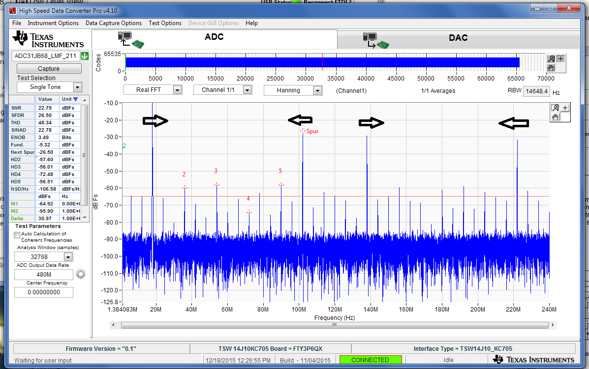

  • I now have the ADC31JB68EVM, the DAC37J82EVM, the TSW14J10EVM, and the Xilinx KC705.
    The DAC37J82EVM + TSW14J10EVM + KC705 combination works.
    I use the DAC3XJ8X GUI to configure the DAC, and use the HSDC Pro to control the KC705 fpga carrier via the TSW14J10EVM. Great!
    Now when I try to evaluate the ADC, things are not so clear.
    I do NOT see an option for downloading ADC31JB68EVM firmware from the HSDC Pro software connected to the TSW14J10EVM, and the ADC31JB68EVM manual does not mention anything about Xilinx FPGA boards.
    Help please!
    - Ian

  • Hi Josh,
    the instructions and files mostly work.
    The issue is that the sample rate is only *half* what is stated.
    I feed in a clock at 500M, and I tell it the sample rate is 500M.
    I feed in a 1MHz signal, and it only takes 250 samples to span the period of the input signal.
    Further, the FFT reports that the signal is at 2MHz.
    I tried sending a 2x clock (ie 1GHz), but then capture times out.
    I tried adjusting the clock divide-by ratio to 2 (on the ADC31JB68EVM GUI), but that also do not solve the Fs issue.
    This is with HSDCPro 4.10.
    - Ian
  • There are more issues. Running at 480MHZ Fs,
    the FFT shows signals at F, 120MHz +/- F, and 240M - F.
    so there appears to be strong aliasing around Fs/2 and Fs/4.
    This is of a sine wave whose frequency increases, and the aliases move at the _same rate_ as F (so not harmonics!).
    - Ian
  • Ian,
    OK, it looks like there were some firmware updates from HSDC Pro v3.1 to v4.1 which required an update to the .ini file. I modifed the .ini and confirmed that it is operational with the KC705+TSW14J10 in the lab. Please see attached.
    Regards, JoshTSW14J10EVM_ADC31JB68EVM_HSDCPro_v4p1.zip
  • When I load the new .ini file, all the problems went away!
    Thanks Joshua!!!
    - Ian
