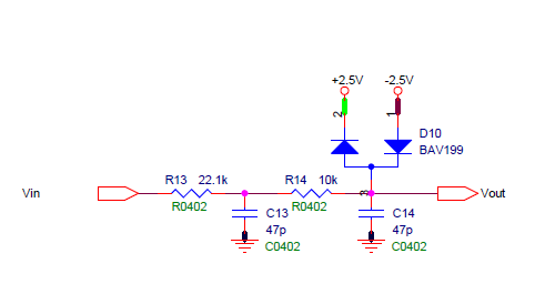

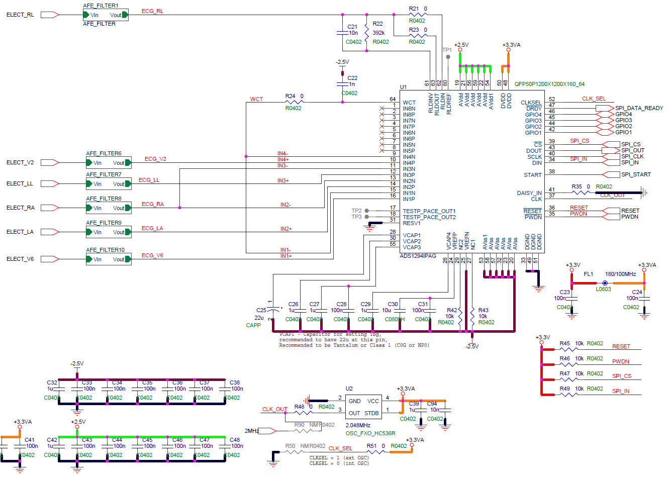

we have made own PCB with ADS1294, and using it for 6 LEAD ECG capturing.
We have an issue with sensitivity of lead-off detection.
Even if electrode is disconnected we sometimes see it as connected.
We use DC Lead-off detection method with current source and tried to change current (6/12/18/24nAmp) with not difference.
We think we are doing something wrong.
Can you please help?
