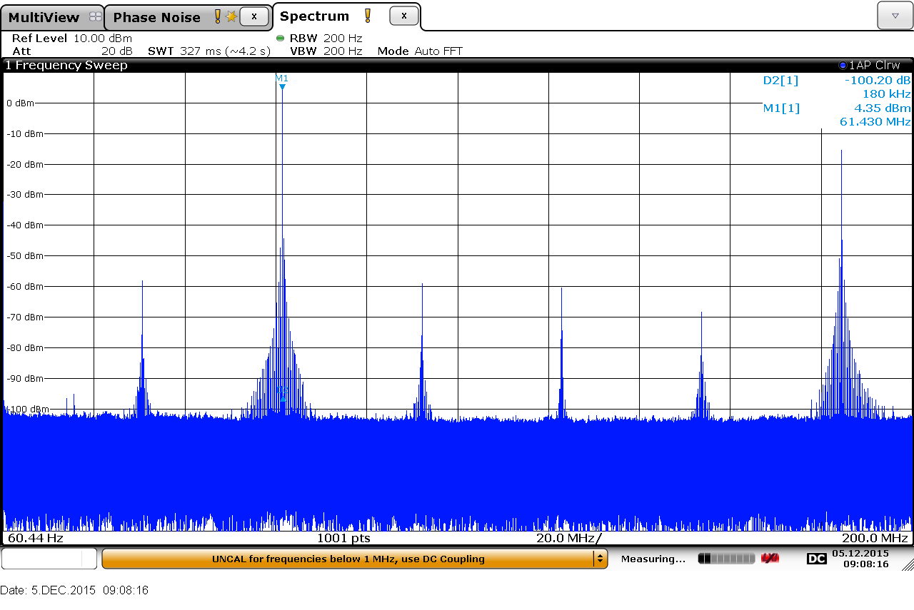

-In addition, I found all the signal I programmed has a very strong odd harmonics (3rd being -20dBc), the datasheet plots shows much lower 3rd harmonic contents of the CW output signal. What makes my EVM odd harmonics contents being so high?

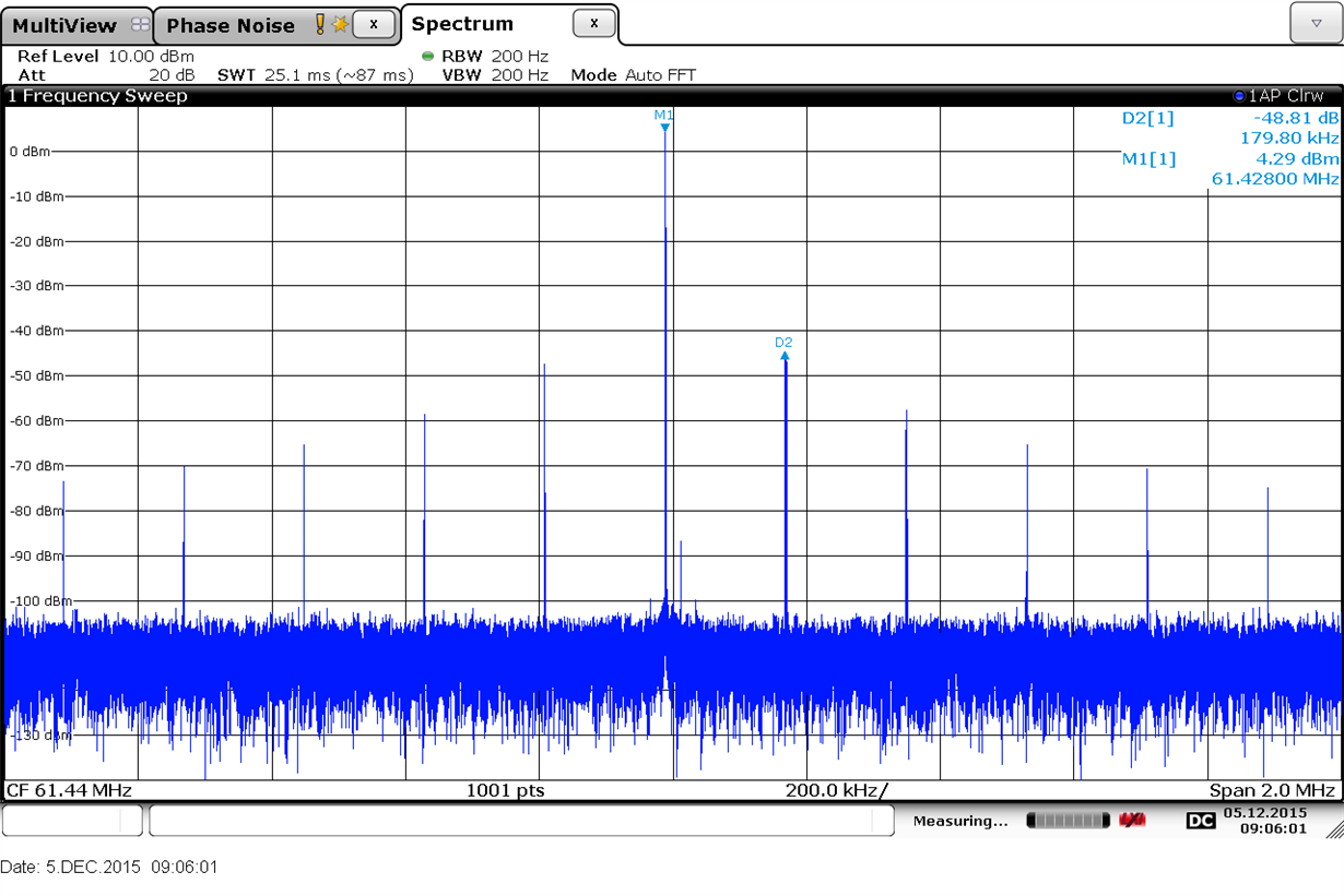

EVM Setup 1:
- DACCLK=983.04MHz
-Y1(OSTRCLK)=15.36MHz
-Y3(FPGACLK)=61.44MHz
-interpolation#=4 (NCO bypassed)
-TSW1400 datarate = 245.76MHz
-TSW1400 # of samples = 65536
-TSW1400 program CW=61.44MHz
-observed close in spur at 179.8kHz away from carrier and -48dB down, what is the source of this spur?

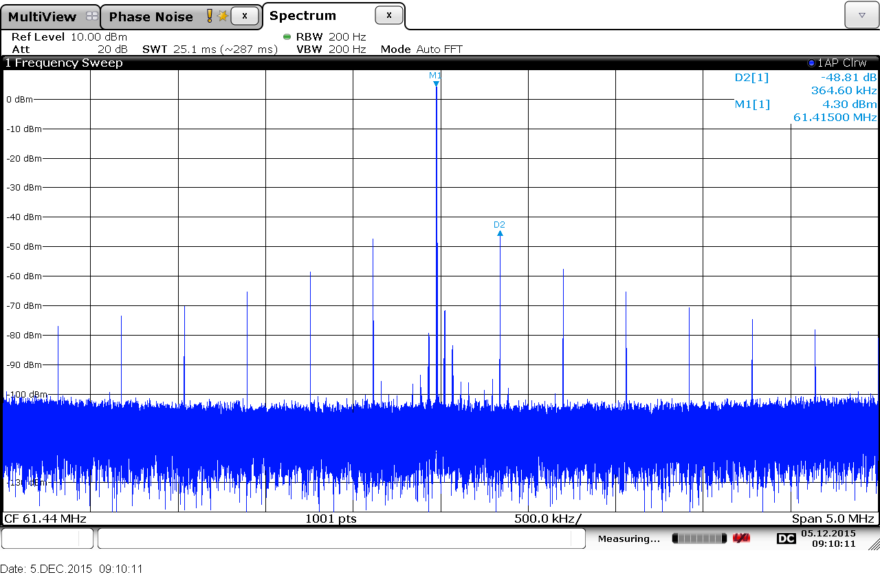

-EVM Setup2
- DACCLK=983.04MHz
-Y1(OSTRCLK)=122.88MHz
-Y3(FPGACLK)=245.76MHz
-interpolation#=1 (NCO bypassed)
-TSW1400 datarate = 983.04MHz
-observed close in spur at 364.6kHz away from carrier and -48dB down, looks like this offset frequency is doubled from previous setting?

- Following is the spectrum of EVM setup 2, notice the large 3rd harmonic contents, also, there are fraction of harmonics observed in between fundemental and 2nd harmonics, 2nd harmonics and 3rd harmonics. What is the mathamtica relationships in my setup produces these fractional harmonics?

    I suspect that you have the QMC gain/phase adjustment circuit enabled with the NCO/complex mixer disabled. The default EVM setup file has the QMC gain set at 1446, which is a 3dB gain to compensate for the NCO/complex mixer mixing loss.
    If you do not have the NCO/complex mixer enabled, having that 3dB gain will cause digital saturation. This may explain all the spurs that you have observed.
    Please try this and report back the spur amplitude. The spurs should disappear to more reasonable level.
    -Kang
  • Kang,
    compression is indeed the case, after disable the QMC gain, the spectrum  is much cleaner. Thanks!
    Florence

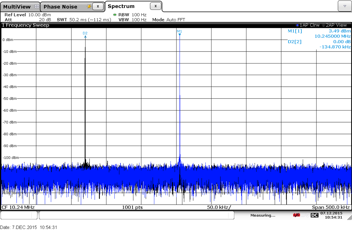

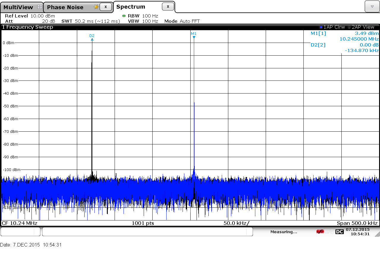

    I programmed output CW signal of 10.24MHz with datarate of 983.04MHz, with Window samples of 65536 versus 32768. I got difference in output frequeny of 134kHz. Also the absolute output frequency is not on target, it is 5kHz off with #sample being 65536. I'd like to understand the frequency error relationship with the datarate and # of samples. Thanks,
  • Florence,
    Besides the standard bin size resolution (i.e. Finput data rate/# sample points), there is also a coherency calculator round up and round down difference in the HSDC PRO tone generator. The coherency calculator is used to ensure the tone generator has smooth transition of samples when looking at the end of the data stream to the next cycle of the beginning of data stream.
    I will ask our software team to try to display the actual tone generated from the coherency calculator on the next version of GUI.
    -Kang
  • Kang,
    Thanks for the input. The bin resolution size seems to be a small contributor, with datarate of 245.76MHz and # sample point being 65536 versus 32768, the bin resolution difference is 3.75kHz, but I saw 134kHz difference in output frequency... So I guess the coherence plays the bigger portion determines the absolute frequency accuracy. Any more info on coherecy calculator, and the factor goes into it, and if it can be predicted how much the output deviate from ideal frequency programed?

  • Hi Florence,
    here are some feedbacks regarding the algorithm:
    The algorithim really is to split the Fs/samples. This gives the Hz/bin. Then you can find which bin it falls into by dividing this into the IF frequency. Then you just put the frequency in the middle of that bin.
    For example:
    Fs=100Msps
    Nsamples=65536
    IF=9M
    Hz/bin=100M/65536=1.52587E3 Hz/bin
    9M/(Hz/bin)=5898.24 Bin
    Round to nearest Bin = 5898, mid bin = 5898.5 bin *Hz/bin
    Actual IF = 100M/65536*5898.5=9.000396..M
    I also just looked at your EVM setup #2, the DAC3482's maximum input data rate is 625MSPS. Your setup #2 has maximum input data rate of 983.04MSPS at 1x int. This setup would not work for the DAC3482. sorry I missed this before. Setup 2 is not really a valid comparison to setup 1.
    -Kang
