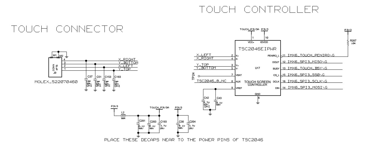

We are using touch controller PN: TSC2046EIPWR in our automotive control panel project.  But when applying high voltage ESD pulses(+/-8KV contact discharge) on the LCD metal back plate (touch panel is attached with this LCD), touch became non operative.
I have not used any ESD suppression diodes on the touch lines(X+,X-,Y+,and Y-) since the datasheet says no external ESD diodes are required. Anybody has come  across same behavior with TSC2046? Please see the touch controller schematic below...

  • Hi All,
    The above post was based on the feedback from our customer on the ESD tests, we have done some experiments and below are the inferences/corrections on above reported issue,
    1. ESD failure is happening only on some particular areas of the LCD/Touch panel (left side and top side to be specific, may be due to panel structure)
    2. Once the touch panel is hung, only power restart of the board can bring the panel to working condition
    3. Terminating the back side metal sheet of the touch panel to the shield ground is not solving the issue
    4. Installing external TVS diodes (SESD0402P1BN-0450-090) on the X,Y lines did not solve the issue
    5. Removed all wire connection to LCD (LCD LVDS Data cable and back light cable ), only touch FPC cable (X,X-,Y,Y-) lines are connected to the PCB, 2CM gap maintained between touch panel and PCB; still on exposure to 8KV ESD pulse, the touch panel hung
    6. While the touch panel is hung , X and Y co-ordinates are read as 4096 ( looks like 12 bit ADC of the touch controller is getting saturated)
    7. Removed the touch panel, and applied 4KV contact discharge directly on the touch connector (just to see the behavior of touch controller ), then we were able to get X and Y co-ordinates as 4096. Same as touch panel hang situation.

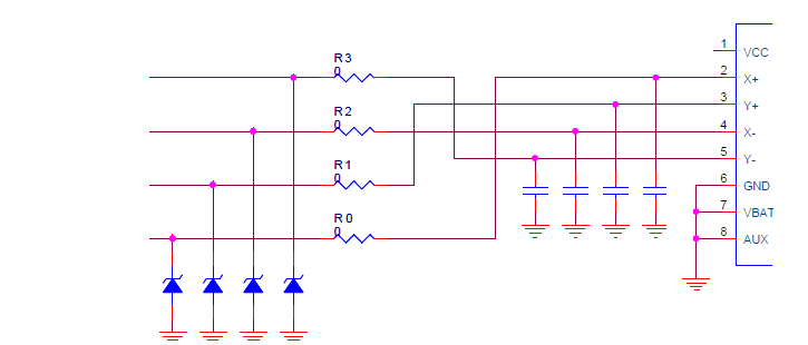

  • Hi Siva,
    Below are my comments:
    a) Try other types of ESD diodes.
    b)  Another thing that the customer can try is to put a series resistor in the analog lines from the driver to form a low-pass filter on the input, but the series resistor has to be as small as possible (I would suggest resistors of less than 10 ohms).  See the screenshot below:
