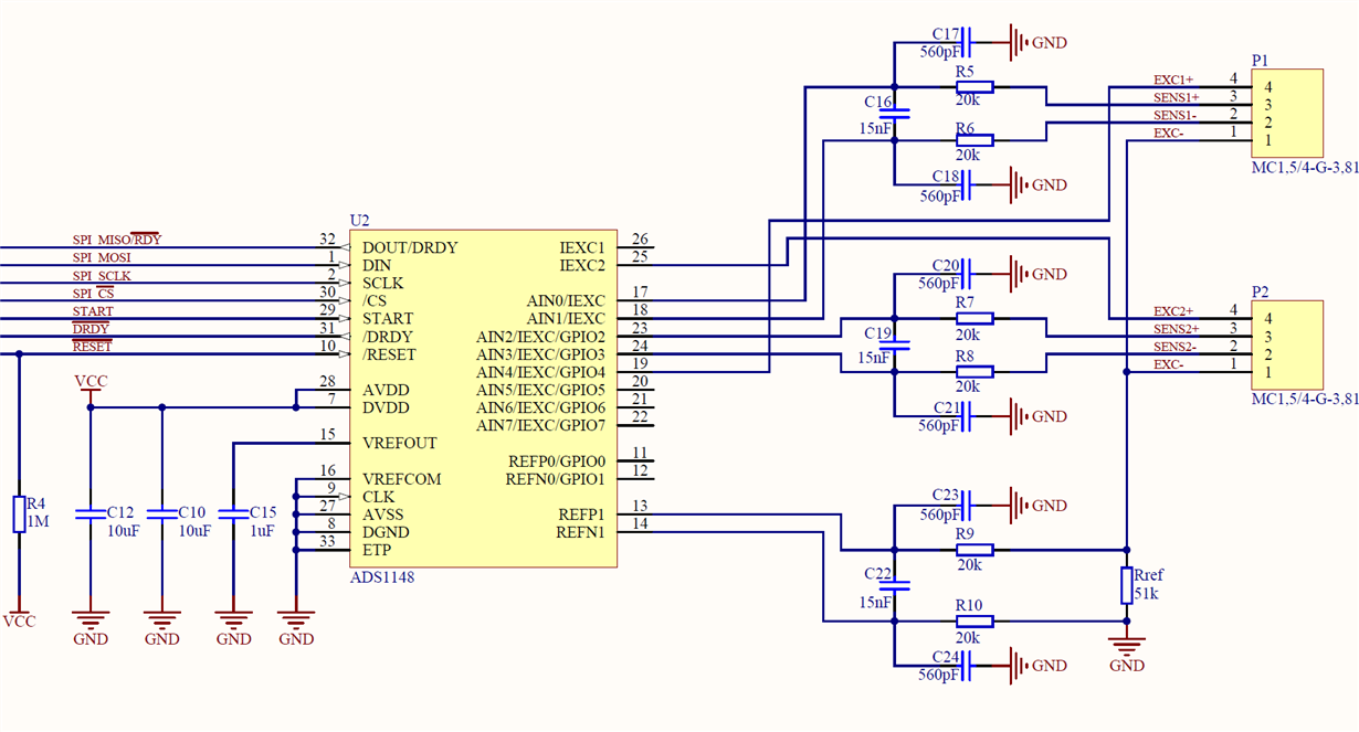

    we have again troubles with the result od the conversion of the adc. After it worked properly on the evaluation-board, we implemented the ads1148 on our pcb. The depending schematic is shown in the picture below. We are using ratiometric-setup to measure a PT1000-Sensor which is connected to connector P1. The SPI-communication works fine (write register and read it again). Now te problem is that the ADS1148 gives a strange  result of around 0x49A9 with a 1k-resistor as PT1000-simulator. We would expect a voltage of 50mV with this 1k-resistor and a exc-current of 50uA.
    Below is the code of one measurement. Since we need a low power operation, we set the ADS1148 always back to sleep by clearing the START-pin.

  • Steve,
    With a 50uA excitation current, you should see about 2.55V on the reference resistor, and as you mention 50mV on the 1k RTD simulator. With the resulting output data, you get 49A9h which translates to 18857d. Making all the calculations, accounting for a gain of 32, this reads approximately 917 Ohms (instead of 1k). So you're close to the right value, but you should be much closer.
    First, check to see that your resistances are correct. Your resistors should be precision resistors, since any errors in the resistance will be a gain error in the measurement. Second, I would measure back the voltages across the the 1k and 51k resistors. They should be 50mV and 2.55V. While they may not have the same exact values, they should have the same exact ratio. Use a precision multimeter so that you can get an accurate reading.
    Check to see if there's anything else connected to the board that might be causing a leakage current. The ratiometric measurement is dependent on making sure that the exact same current flows through the RTD and the reference resistor. Often TVS diodes are used on the inputs and the leakage from that can cause an error.
    Also, your input filtering resistors may be too high. With 20k resistors on the input, the analog input current may be creating a voltage that causes an additional error.
    I'd check those few things and post back the results.
    Joseph Wu

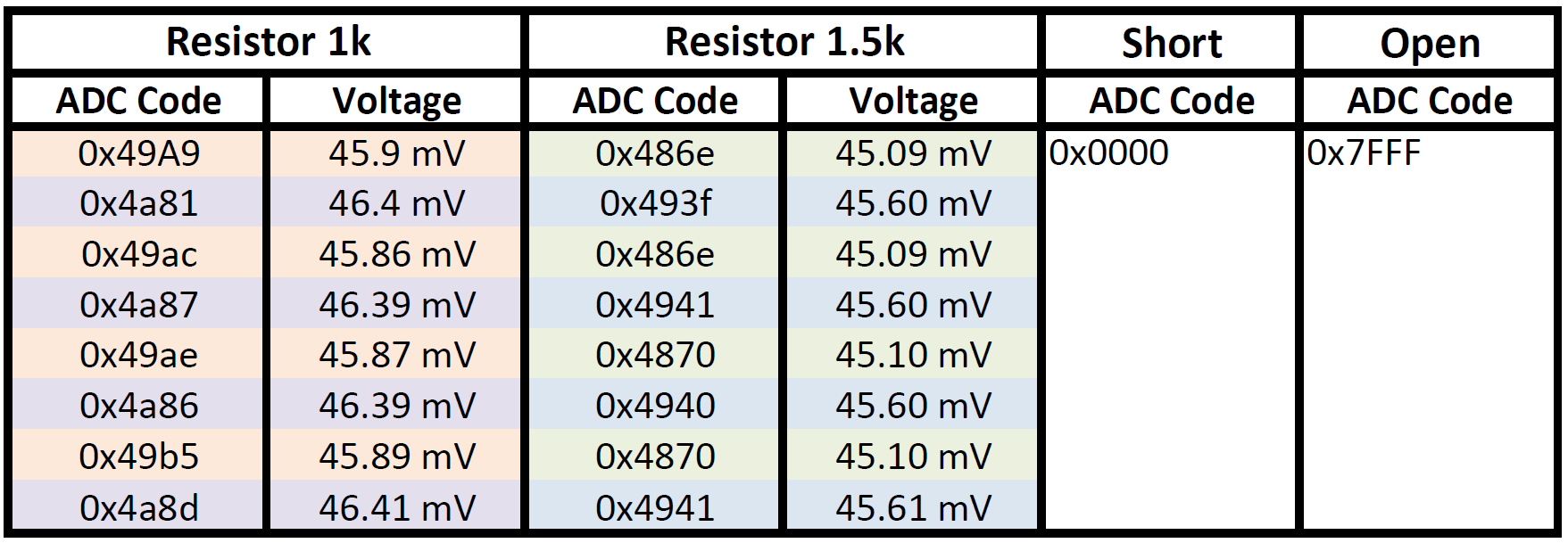

    I did a measurement with a 1k-rtd-simulator and a 1.5k-rtd-simulator. In the table below are 8 samples shown. The measurement result of the 1.5k-simulator is completly wrong. Anyhow additionally there is a toggling in between codes with both the 1k and the 1.5k-resistors. I marked this with fill-colors in the table. Between this toggling values are big steps as you can see.
    After setting down the pga to 4, the adc-code for both rtd-simulators was correct.
    I got the feeling that the cause of my problem is the common-mode-input-range. I use a power-supply-voltage of 3.3V which is connected to DVDD and AVDD. DGND and AVSS is connected to 0V. What do you think ehat the cause of this problem could be.

  • Steve,
    I had assumed that you were running with a 5V supply because you were using a reference that was near 2.5V. Generally, you would want to start with the reference value near mid-supply so that any measurement you make would be within the common-mode input range of the amplifier. The common-mode input range of the amplifier is given in the electrical characteristics table of the datasheet. In your case, I think you violate the upper range which is (AVDD-0.1V-(VINxGain)/2). By using a smaller gain, you fall back into operation. Gain of 4 works, while Gain of 32 doesn't.
    I'd also not that you are close to the upper compliance range of the IDAC current source. I don't think this is a big problem for you because the current gets reduced but the same current still runs through both the RTD and reference resistor.
    If you're using the 50 uA source, try reducing the reference resistor to 33k and re-run the experiment. This lowers the voltage across the reference resistor and puts the input very close to mid-supply so that the RTD measurement is in the common-mode input range.
    Joseph Wu
  • Hi Joseph
    I changed the reference-resistor to a 33k und the pga to 16 and it works perfectly now. Thank you for your fast and competent help!
