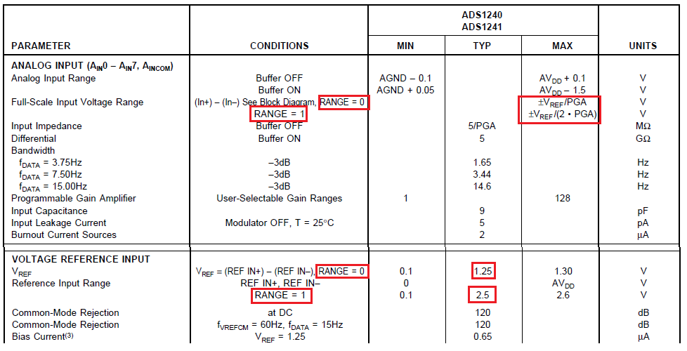

1.)
Datasheet shows following specs for AVDD=3V.
Dose it means that input fullscale range always 1.25V?
RANGE = 0 ±VREF/PGA V ←Vref should be 1.25v on datasheet. PGA=1
RANGE = 1 ±VREF /(2 • PGA) ←Vref should be 2.5V on datasheet. PGA=1

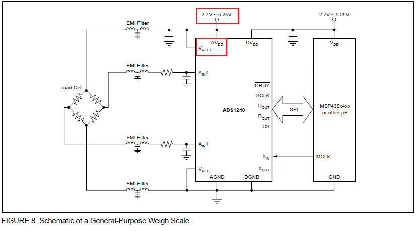

Customer's condition is following and they would like to input 2.5V full-scale.
AVDD=3.3V、VREF=2.5V、RANGE=1、PGA=1、between Ain1 and AinCOM(GND)、format=unipolar
Following shows "FIGURE 8". It connect same voltage for AVDD and Vref.
Is Vref over voltage(such as 2.7V and 5.5V) for datasheet spec?

    1. I believe that with AVDD, it forces the input full scale range to be 1.25V. As you mentioned in a previous post, there is a section that says:
    For AVDD = 3.0V and RANGE = 0 in the ACR, the differential VREF must not exceed 1.25V.
    For AVDD = 3.0V and RANGE = 1 in the ACR, the differential VREF must not exceed 2.5V.
    With the ADS1240, I don't believe that at AVDD=3.3V and VREF=2.5V the input full scale range will reach 2.5V full scale.
    2. I'm not sure of the figure, but it would only work for the case where AVDD=5.0V and RANGE = 1. In that example, you would still be limited to a full-scale range of 2.5V.

    I've checked with the designer about this part and the problem is the sample charging when the reference is at a higher voltage.
    If the reference voltage is too high, then the sampling within the delta-sigma modulator may have charges that go higher than the supply. If this happens, then the charge leaks from the modulator. Since this is part of the reference sampling, I'm not sure if you see the charge equally through the input range, but it's likely you would see a very large gain error and integral non-linearity.
    I would have them look at different input voltages (measured with a precision multimeter) and see how much of an error there would be. I suspect that this error would be worse at higher temperatures.
    Regardless, his recommendation was the same as the datasheet. Do not run the device with such a high reference and RANGE=0. Use RANGE=1.
