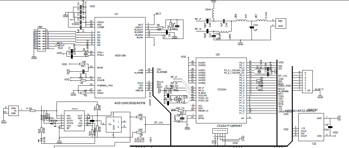

I was just trying to communicate ADS1293 with CC2541 through SPI. The problem is that the ADS1293 is not responding as there is no signal on the MISO pin.
I wrote a value to the first register of the ADS1293 and tried reading it back but in vain.
Here is the code snippet of what I am trying to do:

TI_ADS1293_SPIWriteReg(0x00,0x01);
while(1)
TI_ADS1293_SPIReadReg(0x00);
Please help me out.
