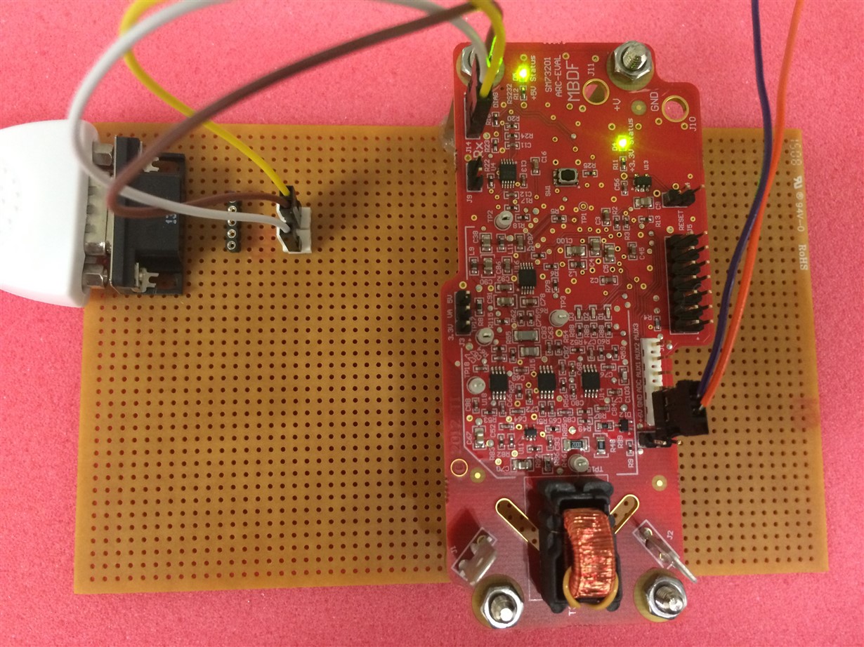

Hi comunity, im new here. I  just bought an eval board for arc detection.
First i just power the eval (step1) and can't verify the propper function of LED (no one is blinking)

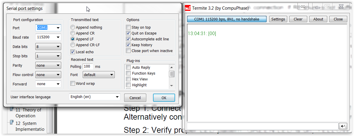

Second: I just connect to Rs-232 port to see the parameters and have no answer from the device. (just trash [00])
Please help me.

  • hi chris, the RD was replaced by a new one and we got same issues. It is possible that 2 boards have same problems or are we missing someting?
    the COM port is tested, the cable is tested, there's no communication by any software as termite, hiperterninal or arc tune TI software.
    In adition, the RD when is powered only turn on the power leds (D4-D5) but D1-D2-D3 are off all time. (thats mean the board dont follow quick setup guide, as far as i know is basics, custom functionality of the device).
    We also use different platfors (win unix) just in case. This is importan for our company, our project cant go on because our testing tool (RD-195) doesnt work propperly.

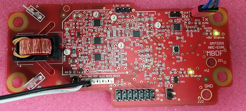

  • The picture you provided seems to show that all the pins on J5 are present - was there one pin that was cut on J5? There should be 1 pin cut off on J5 in order to attach the programming header onto J5. The programming header is keyed with one pin for proper orientation; this means that the programming was not done.
    I am looking into the stock now.
    ChrisO
  • Ur fully right, in both boards have all pings on J5, i supposed that was a programming connection but no information on the manual. If is possible please contact Blas palencia, hes ti's in charge of my problem. I'll call him asap.

    1. Upon power up - LD 4 and LD 5 are on , no blinking of status Led is observed.
    2. While manually pressing the SW1 , no self test inferences are observed.
    3. The communication with device is also not operational. We have tried it out with , termite, hyper terminal. With my knowledge i would have to assume that device has not been programmed.
    4. Please find the RD195 board images below - It seems that the board is not programmed. (All pins of J5 port are present)

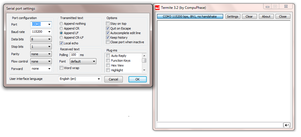

    3. Communication setup - RS232 - The status is connected. However, the board is not responding. PFA.
    (a) Termite:
    (b) Hyper Terminal

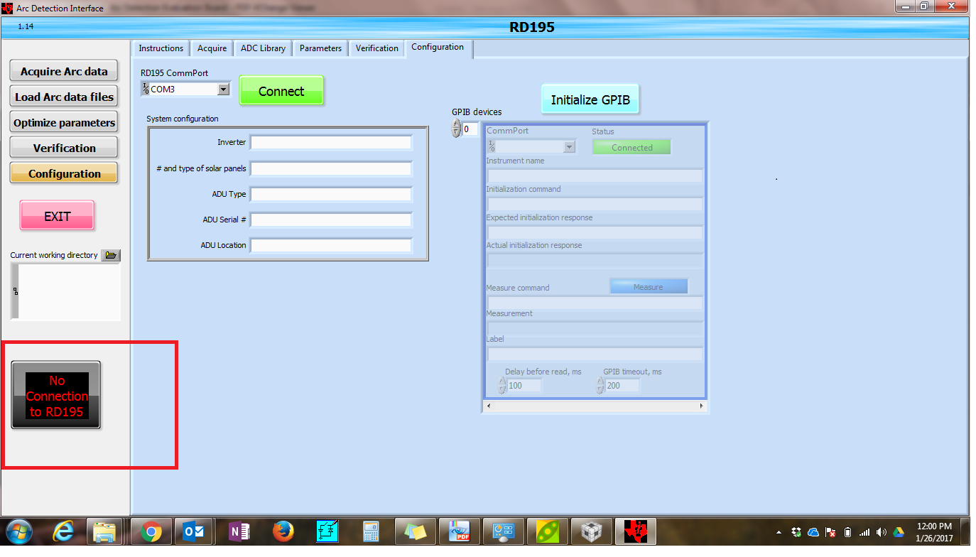

    (c) TI Arc Detection GUI - It is able to identify COM3. However, the status is NO CONNECTION TO RD195

  • Good morning Abhi, im not a Texas engineer but i've got same problem and got the solution.
    If u see in ur photo: J5 connector have all pins this mean that the uC wasn't programmed. My suggest is to inform this to the engineers of TI and they will send you the way to fixit.

    My apologies for the delay in response on this matter. The issue you are experiencing is due to the several RD-195 boards not being programmed. If you have an unprogrammed board and a JTAG programmer, you can use the attached file to update the FW. I recommend returning the board to TI and asking for a replacement unit, as the stock issue has been corrected.
