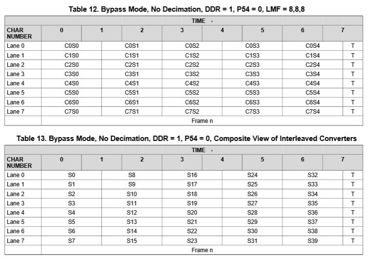

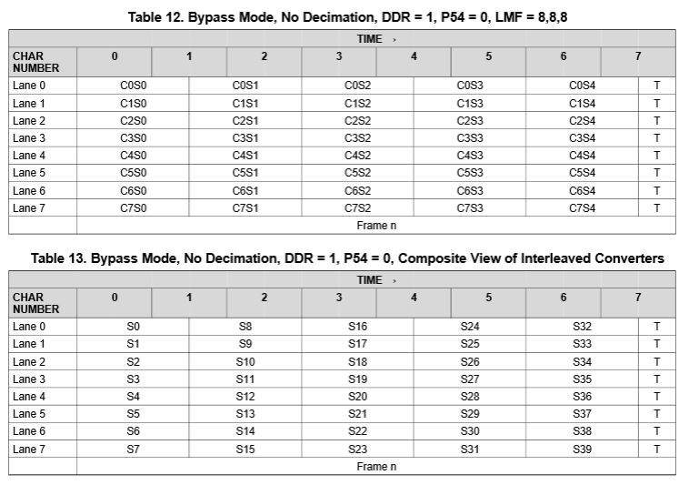

Hi, i'm reading the datasheet of ADC12J4000 and I would to know how the samples are formatted between lanes, without decimation.
At the page 40 there are 2 tables about this. The first has L=8 M=8 F=8 and I if understood it, so I have the same sample on 8 "differents" ADCs at the same time, right?
In the 2th table, there's "Composite View of Interleaved Converters" and so I have 8 consecutive samples on 8 Interleaved ADCs at the same time, right?
How can i select the "Interleaved Mode"?
