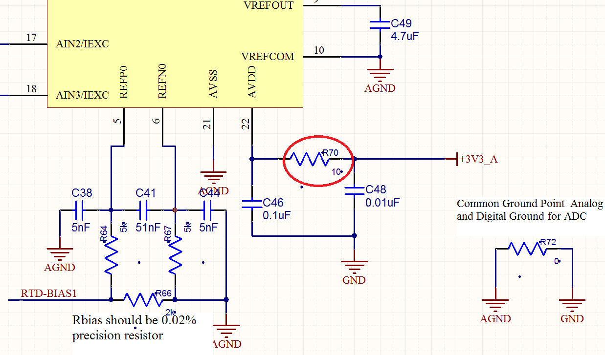

Before I used the ads1248 chip to measure the 3 RTD100 temperature signals in my old board. I used the 3 differential inputs and the 4-wire RTD interface.
The following was some important configuration:
Excitation Current: 250ua
PGA:16
SPS:80
Rbias:2K
The old board is good.
Now I use same design in my new board. There are two ads1248 chips because I want to measure 6 temperature signals.
I can read the digital code from ads1248. I will get a sampling value every 1/3 second, So I will sample all three channels in one second.
But some error in the reading value. Normal value should be 7235XXX, the real value is 7516XXX.
When I change the SPS value, the reading value will change too.
SPS=80, Reading value=7516000;
SPS=320, Reading value=7235000;
SPS=1000, Reading value=7106000;

  • Fei,
    Are you cycling through the three readings? My guess is that you have extra capacitance on your input or reference that is slowing the settling in the RTD or reference resistor. While setting the excitation current to a new pin is relatively instantaneous, the filtering capacitors that you have (or other external capacitance) will still need to charge or discharge, depending on the set up.
    I would try an experiment. Make the 3 measurements by taking one sample each. Then, do the same thing by taking 20 measurement each before moving to the next channel. Do the values change between the different reads? Does it look like the measurement is settling with the 20 consecutive measurements?
    Then look for capacitances or resistances on your schematic that cause RC time constants that might make the difference in what you see for the different data rate readings. If you need some help, feel free to post the schematic here.
    I might also try removing some of the input or reference capacitors on the board to see if this helps. You may need to add some delay into the channel cycling to get measurements that are more accurate.
    As for the calibration, the ADS1248 is factory-trimmed for gain for each of the PGA settings, which is set each time the PGA is setup in the device. In this case, a gain calibration is probably not necessary. As for the offset calibration, we've said that a calibration should be done after powering on, a change in temperature, a change in PGA or sometimes a change in channel. This depends on what sort of offset that you are willing to accept. It's likely that if you keep the same gain, you could just set the PGA and live with any offset drift that you might see after the calibration.

  • Hi, Joseph,
    Thank you for your detailed answer.
    Now my ads1248 chip works correctly. The problem is from the hardware. The voltage on the AVDD pin is not 3.3V, it is a little lower voltage.
    A bigger or smaller AVDD voltage will change the sampling result? It is strange. OK, do not care for it.
    Now If I change the SPS value, the sampling value will not include a big error. It seems the error gets smaller when using a bigger SPS value.
    I did not do the gain calibration. About the offset calibration, it is done only when power on.

  • Fei,
    I'm glad that you were able to get it to work. I'm a little surprised that the problem was that the AVDD was a little lower than expected. How low was the value?
    There are some small differences in operation with different AVDD. This includes the noise (which is shown in Tables 1-6), the PSR, which is explained in the Electrical Characteristics table, and power supply current shown in the Typical Characteristics curves. All of these are relatively minor effects and I don't think it should significantly affect your performance. I would note that with a low analog supply, you need to be careful on selecting your RTD, reference resistor, and the excitation current. The compliance voltage for the excitation current only goes to AVDD-0.7V.
    If there is no RTD sensor in the connector, it is likely that the AINP will be pulled up by the excitation current source, and the AINN will be pulled low from the lack of current going to the reference resistor. In this case, I would expect that the ADC would over range and give you a full scale reading of 7FFFFF. If you need any other evidence, you can use the system monitor and use the internal reference to read the external reference value (either pins to REF0 or REF1). If the reference reads 0, the excitation current isn't going through the RTD to the reference resistor.

    This is a old design. It can work in the old design.
    Please look at the resistor R70. In this design its value is 10ohm/1%. I can not understand it. I think it should be 0ohm.
    In my old boards, this resistor can be 10ohm/1% or 0ohm. They can work correctly.
    I removed a R70 resistor from the new boards, I found it is about 15 ohm. Then I got the bad measurement.
    Then I changed it to 0 ohm, everything is good.
    Fei
  • Fei,
    I'm glad that worked for you, but I'm not sure that was exactly the original problem. I think the original intent was to low pass filter the supply to make sure the supply was well behaved. Since the supply current is typically lower than 500uA (or equal to that at the highest data rates), there isn't going to be much drop across this resistor (only 5mV with the 10Ohm resistor).
    Anyway, if the device is now working. I can't argue with it. Let me know if you have any other questions.
