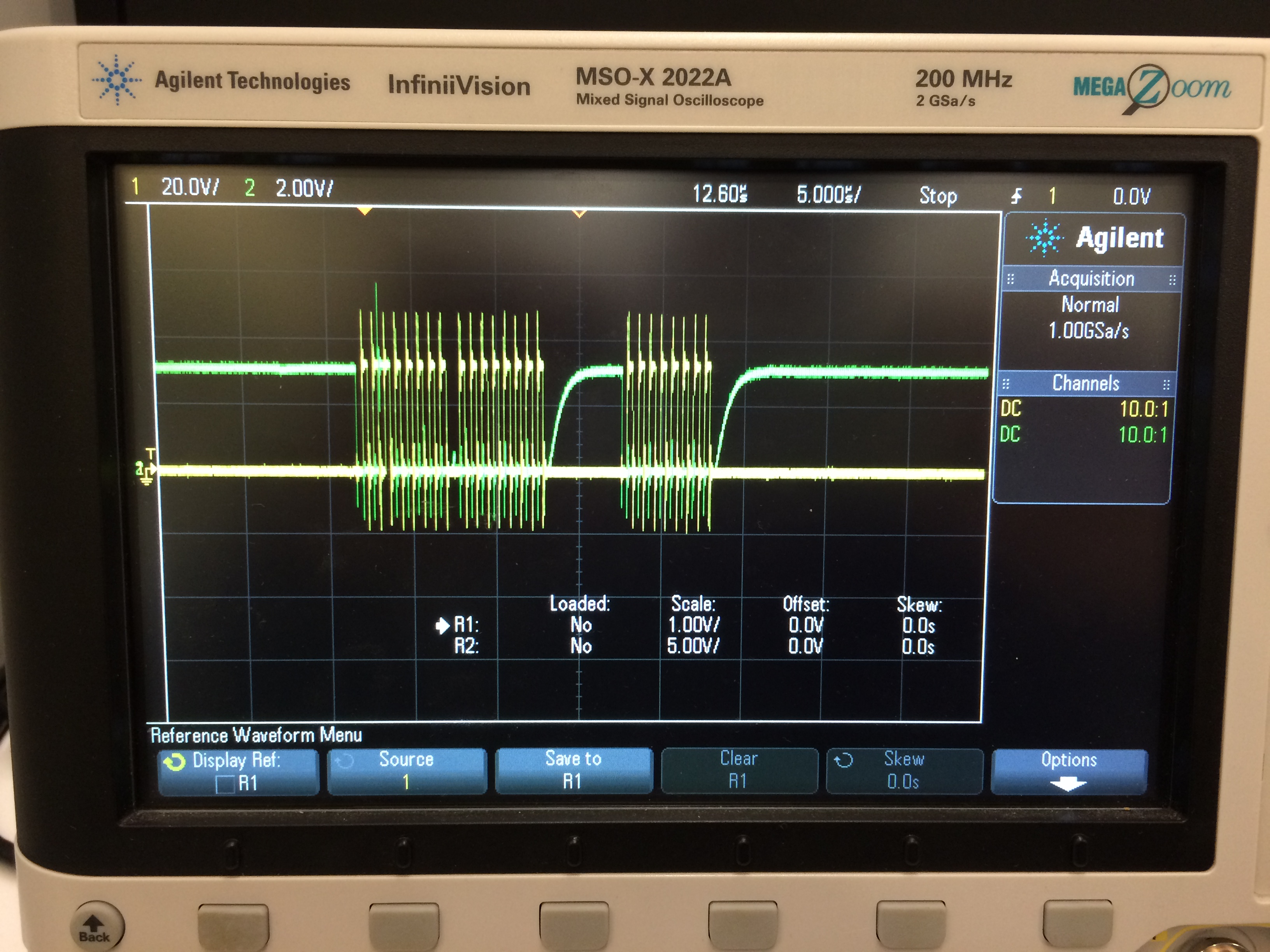

    The folloing is the timing that I captured. The first is about SPI SCLK and CS, and the second is SPI SCLK and MOSI, and the last is SPI SCLK and MISO:
    I checked the timing, the data sent is 0x20, 0x00, and the data received is always 0x00. About the schematics, I need to confirm with my boss. Could you please tell me whether the power sequence and initialization flow that I listed above is correct?
    And please help to check the timing is correct.
    Thanks a lot.
  • Hey Mian,
    Your timing should be fine as long as those delays that you don't specify meet the requirements given on page 57 of the ADS1299 datasheet. One thing you could do to verify that the device is powered correctly is to pull the start pin high and look for the periodic DRDY signal on the scope. If it never appears, its definitely a power-on issue.
    Looking at the oscilloscope screen shot you gave with SCLK and MOSI, can you confirm that MOSI stays high during the third falling transition of SCLK and satisfies the 11 ns hold time? The interface latches inputs on the falling edge of SCLK so its critical that timing specification is met. For this interface CPOL = 0 and CPHA = 1.

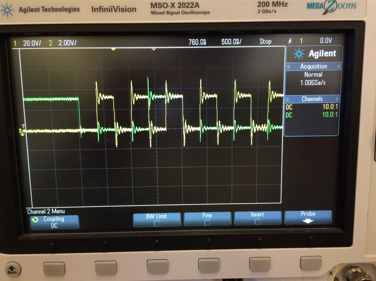

    I checked the SCLK and MOSI, and it seems OK. Here is the pic for SCLK and MOSI in bigger size below:
    Just hope you could take a look and help me to double check. The command is 0x20.
    And if you have any other suggestions, please tell me.
    Thanks a lot.
  • Hey Mian,
    This confirms my original suspicions about the incorrect SPI settings. Refer to page 8 of the ADS1299 datasheet and look at Figure 1. Notice how DIN transitions at or around the rising edge of SCLK and is in a known state at the time that SCLK transitions low. This is critical for the device to have latched the correct value for DIN. In your image, you can see DIN transitioning on the negative edge of SCLK which is not valid for this interface. Change the SPI settings to CPOL = 0 and CPHA = 1 and look at the transaction again.
    Brian Pisani
  • Hi Brian,
    Thank you for your explanation. Now, I changed the SPI mode and can read device ID. And also I can configure sampling frequency.
