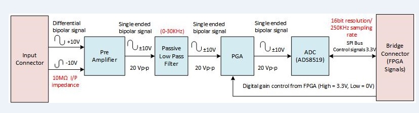

I have a differential bipolar signal with the range of (+10v to -10v) 20vp-p signal, This signal is connected to the input of pre-amplifier stage to convert the differential bipolar signal into single ended bipolar signal (+10v to -10v). The output of the preamplifier stage is connected to the PGA to varying the gain of the signal.
My question is Shall I connect directly the output of PGA to ADS8519 ADC or I need to buffer the PGA output signal and then fed to the ADC (ADS8519). I am attaching the block diagram for your reference, Please advice me.
