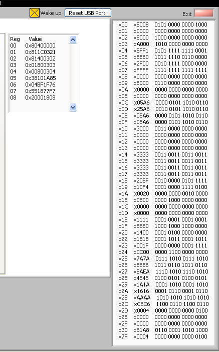

But when I press the "Send All" Button or do changes in the CDCEC62005Control Card, the output is going off, and the internal clock I use is off, too.
The CDCE registers are unchanged since power-up.
Have I wrong adjustments of the CDCE? Or what else could be a reason for that behaviour?

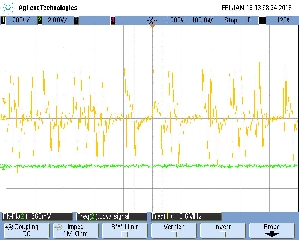

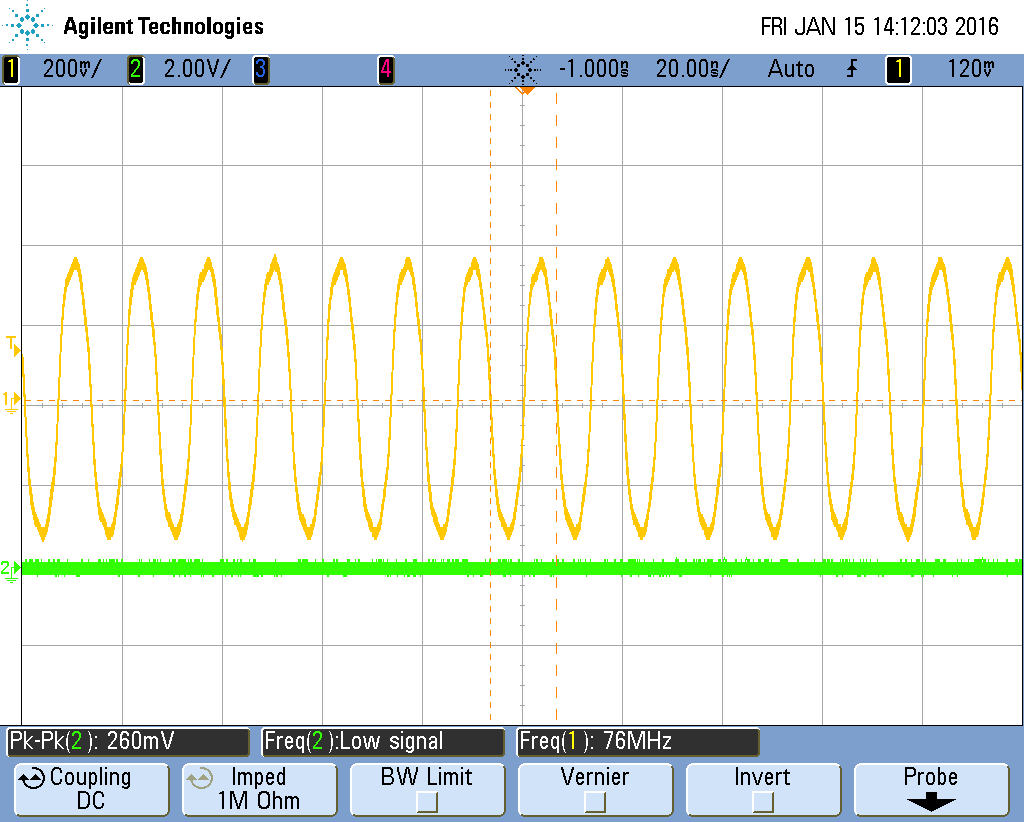

  • Hello
    I use the clock generated by CDCE62005 (DACCLK). CDCE62005 use the on board reference clock from U17 (SEC_REF)  (no external reference)
    This clock is going out when I click the send all button. Also the FPGA_CLOCKOUTP/N from CDCE.
    DACCLK is not at zero when the error occures. See Channel 1 of the scope. First picture is before I do changes in the DAC348x Software Control, second picture after.
    The clk-Signal from U17 (SEC_REF+/-) is still there.
    Does the DAC348x Software execute a VCO Calibration?

     Digging through my email, I found the following behavior of CDCE62005 when configured with the DAC348x software:
    The CDC output will turn off when the CDC LE transitions to high for about 1.6 usec.  This will happen no matter which register is programmed or whether the register values are actually changing.
    As a interim solution to the problem we have modified the GUI so that it will not write to the CDC on every iteration.  Now it will write to the CDC only when on the CDC tab *and* a register is modified, or on the first iteration, or when the user selects “Send All”.  For the most part this will eliminate the problem during normal usage except when the user selects “Send All”.  This will cause the issue to happen and will require the user to toggle Sif-Sync to recover.
    We noticed that that moment CDCE62005 LE transition to low, the clock should recover. The clocking forum should be able to help you if you are designing the CDCE62005 on your PCB.

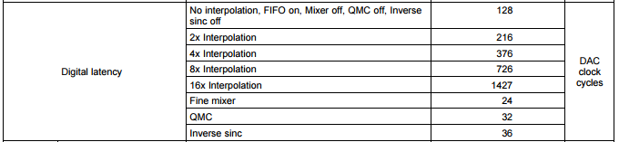

  • Michaela,
    The propogation delay is defined as the time for the signal to cross from the digital core to the DAC analog core. You will also need to account for digital latency specification as well. Multiple the number of clock cycles by your DAC sampling time to get the result per the mode that you are using.
  • The DACCLK is 500MHz, so it is a delay about 90 DACCLK cycles. The Mixer is disabled, also the QMC and Inverse sinx/x filter.
    Is there a digital latency by bypassing the FIFO?
  • Hello Michaela
    Bypassing the FIFO only reduces the digital latency. There are still latencies from various DSP blocks such as FIR interpolators, QMC, and sinc filters.
