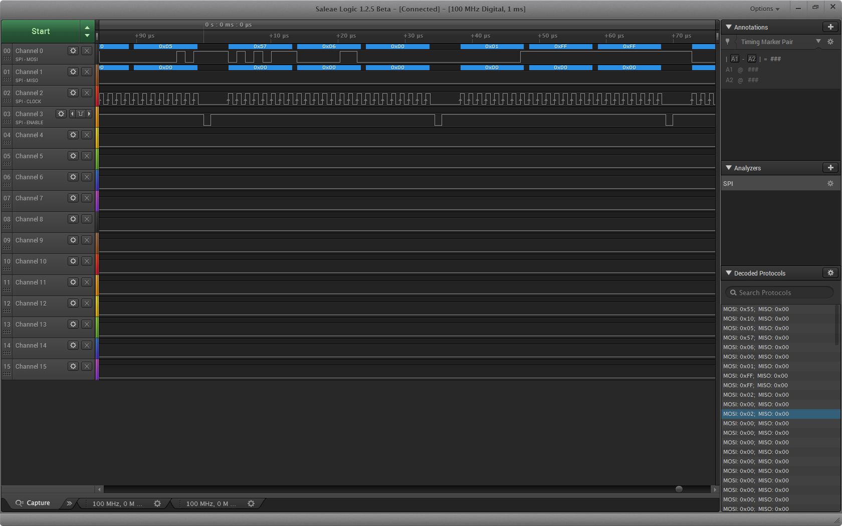

DAC7760 (Eval-Board) interfacing with TMS320F28377D (EVAL-BOARD),trying to communicate with SPI.
Thanks for your fast response !
I am not able to attach the Saleae File capture, so sending out a screenshot.
The SPI-CLK is running at 781 KHZ .  The following details are regarding the capture-
1> Channel 3 is the Latch signal giving from the DSP(by using a GPIO).
2> I am not able to get latch exactly at  LSB of the data.
3> Also as I mentioned before, if I don't give the  delay between consecutive transmissions (say between consecutive WRITES) I observe that  just the last/recent transmission being transmitted. Might be because  I am writing to the register too fast , that it has not completed the previous transmission.
I request for your guidance on these issues.

  • Hi Prashanth,
    Thank you for the screen capture. It looks to me as though you are trying to latch data on the falling edge. This device latches data on the rising edge of SCLK.
  • I am not able to see the 24 bit transmission if I don't give the delay between consecutive transmissions (say between consecutive WRITES) I observe that just the last/recent transmission being transmitted. Might be because I am writing to the register too fast , that it has not completed the previous transmission.
    Is SCLK slow to take the data out from the MCU?

  • Can you provide a capture of this case as well?
    The SCLK being slow should only improve the performance of the SPI. As long as the data is being latched on the correct SCLK edge.
