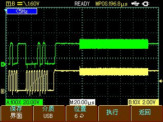

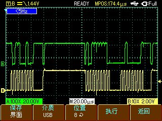

           Thank you for your suggestion, I am running with S3C6410 .There is  a strange issue.  At first,I reset the chip , and I can get chip ID ,and access(R/W) other register well, but if I write a value (0x05) to the chip sub-address 0xB2, then I read data back from this register, I get the value is 0x20. if I write other value into it , I get back 0x20 also! (This register is written to video decoder core 0.)
          I try to  write some value to other registers(R/W), I can get right value back . Is there a  relationship with between accessing 0xB2-register and firmware updating ?or the chip I tested is bad ?
        Following picture is  a IIC waveform of writting  0x05 to the chip sub-address 0xB2.
    Following picture is  a IIC waveform of reading data from  the chip sub-address 0xB2.( the back value is 0x20)

  • Hello Jerry,
    There is a problem with bit 6 of register B2h in ROM.  Can you try to download the patch to see if it works for you?
