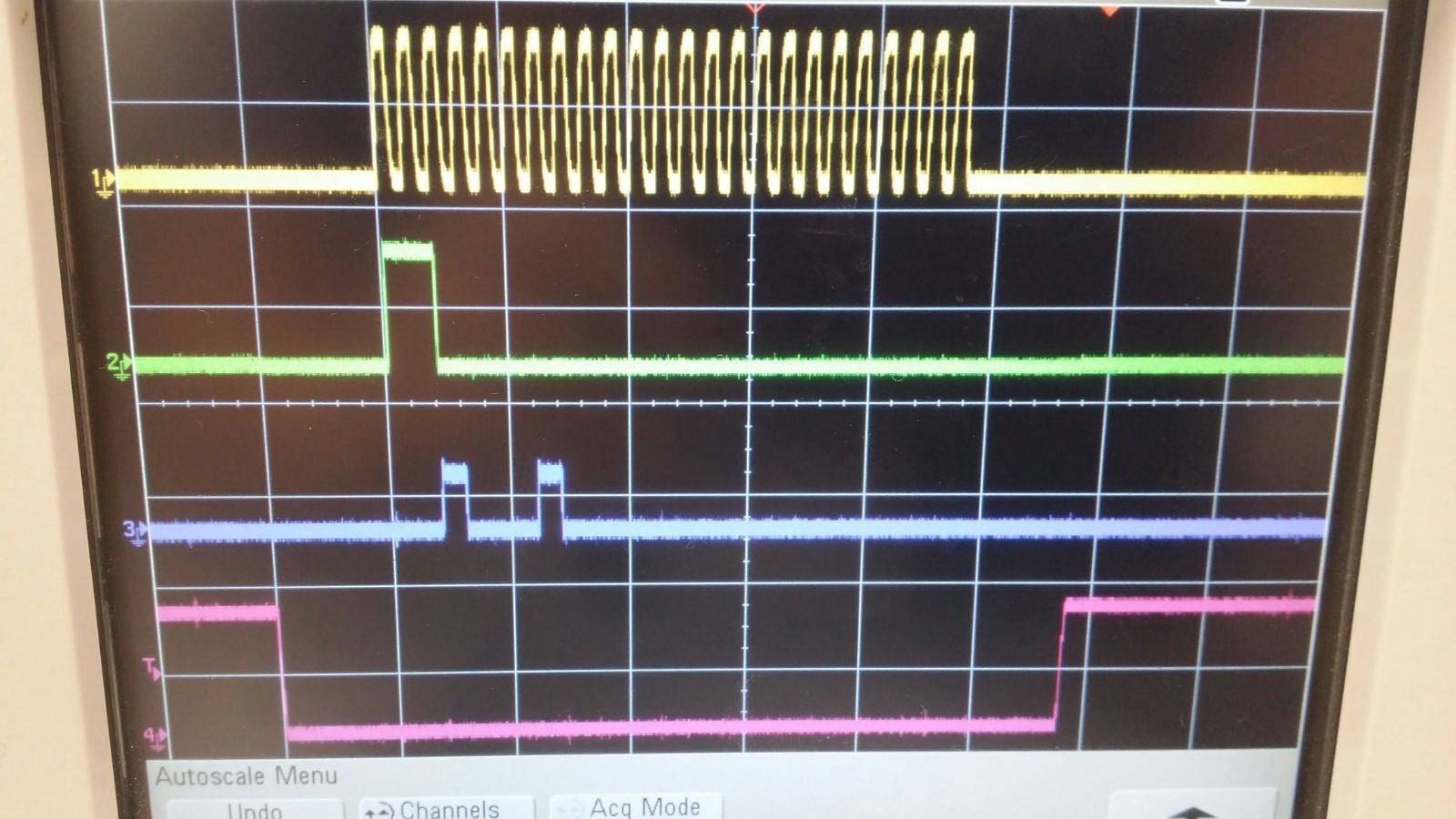

i use nrf52 DK as master and configure ads1292 breakout as slave. . I write the sample spi code  to read the value of the specific register in the ads1292. what happen is that the CS ,SCL,MOSI signal are all correct, but the MISO signal is always wrong.
yellow color is sclk,green color is miso, blue one is mosi,pink one is cs. no matter what register i read, the green signal (miso)is always like that. I attached my code as follow。

  • Hey xin,
    Have you sent the SDATAC command before reading the register?
    Brian Pisani
  • Thank you, Brian.
    I have solved the problem which ia mainly due to wrong initialization of SPI (wrong clock trigger mode)
    now i successfully achieved spi read and write function in ads1292 breakout board.  actually, I used the ads1292 breakout to verify the spi testing code.

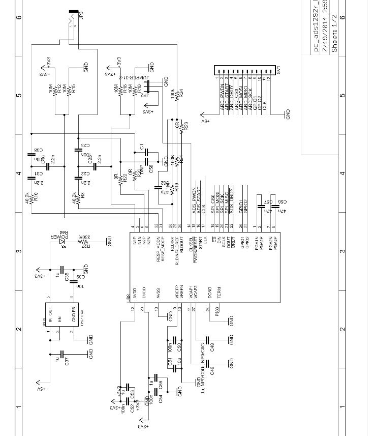

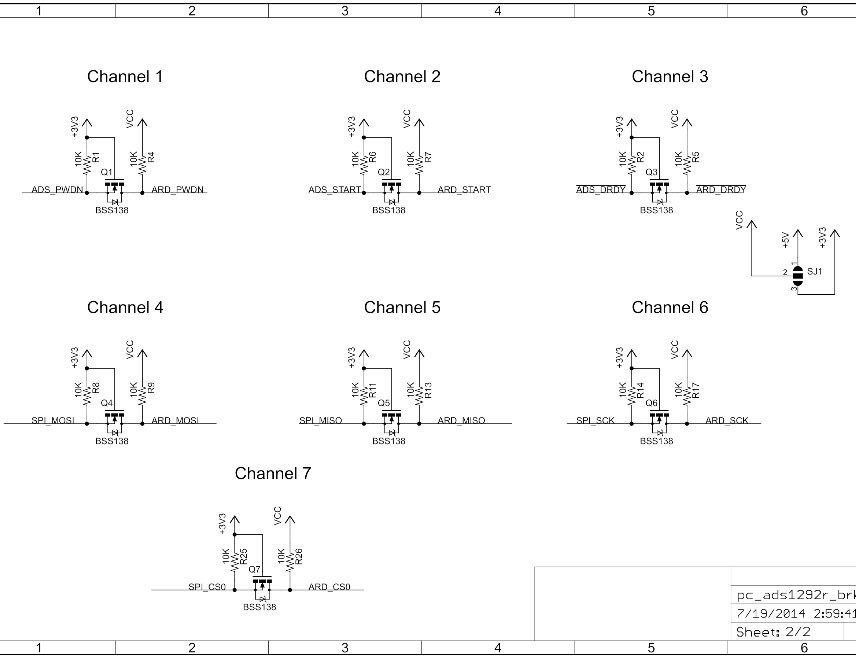

  • Hi brian
    Thank you very much. it works on ads1292 board after i added SDATAC command. however, when i run the same code on ads1192 board designed by me , it still faults out. i think ads1292 is quite similar with ads1192. is that fine to use same code for both ads1292 and ads1192?(the code only work for register read)
    the ads1192 schematic is like that
    the ads1292 schematic is the following:

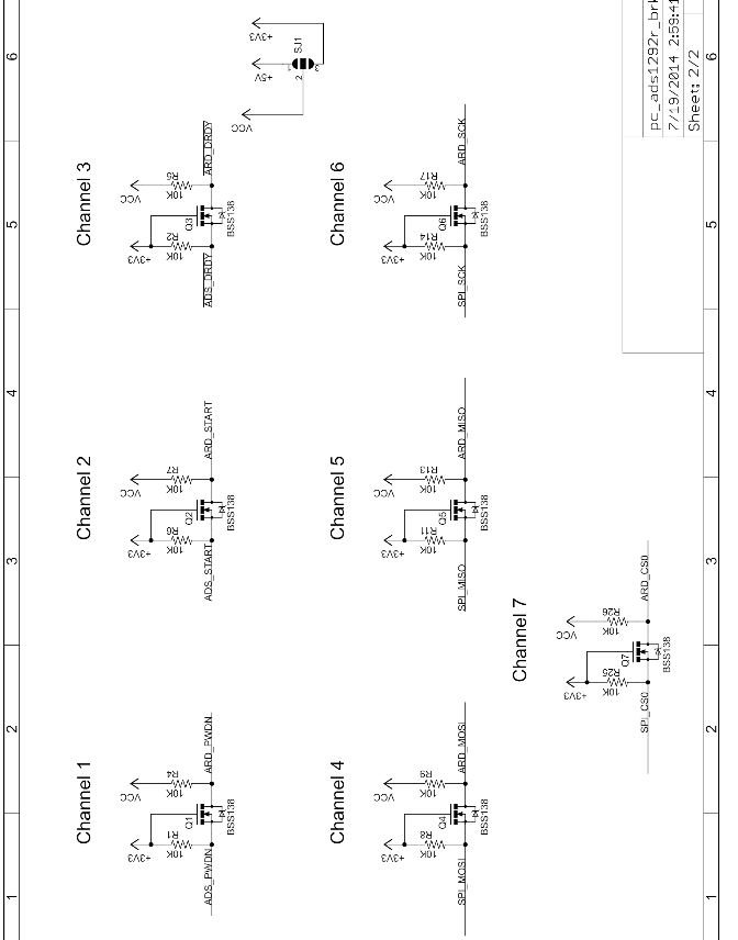

  • Hi Brian:
    Thank you for your reply, I have check both ads1292 and ads1192 schematic. most of the connections are same, the most different part is that the pull up network are added to the spi(PWDN,MOSI,MISO,START,SCL, DRDY) interface on ads1292 borad. on ads1192 board, i didn't add those pull up network and  just directly connect the spi pins to mcu.
    the pull-up network is like this
    And i have verified the spi transactions on both ads1292 and ads1192 board. just like i said, I use the same code to run on those two boards. only ads1292 board that can work.(write value to register of ads1292 and read it ).  for ads1192 board, it can't work(can't be written or read).
      1. theoretically, is it correct to run the same code on both board based on those situation?
      2. Does the pull up/pull down network really affect the spi or should i modify the code due to those pull up or pull down network.
    reaaaaaaaaaaaaally thank you ,Brian. You help me a lot!!
  • Hey xin,
    1. For reading/writing registers, yes. Retrieving data would be different, though, since the ADS1192 outputs only 16 bit data. In your case, I'm looking for differences in the hardware that could affect how things work.
    2. Maybe. I would try checking the interface on the device side of the pull-up network and make sure everything looks like it should.
    I notice you are using a 2 V buck output to power the digital core of the ADS1192. Check to make sure that voltage never dips below 1.7 V. If it does, the part could be powering down. I would also advise you check to see if the device is powering down by looking at the DRDY signal. If it is coming at the default data rate, then you can be sure the digital core is powered correctly.
