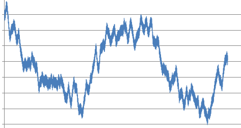

I would like to ask you about the architecture of ADS1248.
Does ADS1248 employ a "feedback" signal processing to reduce the output errors?
A Feedback means that the output is feedbacked internaly to input to compare,  like "OPamp feedback".
Because one customer has observed following data  which changes slowly and periodically.(about 10Sec/cycle)
This data is temperature data of "Thermocouple".
The customer is concerning that this data changing is due to ADS1248 architecture.
But I am thinking that seems to be due to "environmental issue of measurement"...
I would like to ask you to give me any advice about this.
Thank you in advance.
  • Takumi-san,
    The ADS1248 does not employ a feedback structure as you are describing. The way that the offset is reduced in this device is a front end chopping (the graph does not look like any chopping effect). I agree with you that this looks like it is some sort of environmental measurement issue.
    How large is this error that they see? For the plot, can they provide the raw data? What is the time scale of the graph? I'd also like to know the configuration of the device (PGA gain, data rate, what reference they use, and the schematic). This does look like some sort of 1/f noise, but I need to know more about the customer's circuit.

    I've had a chance to look through the data that you sent me and it looks like there's a variance of about ±0.4% over the course of about 3 hours.
    My guess would be this is some sort of temperature drift over that amount of time, but I'd need more information about the circuit, what they are measuring, and the setup of their system. If it is some sort of temperature drift, it might help to have a some enclosure around it to help remove temperature fluctuations. If the enclosure is metal, then it might also help with EMI as well.

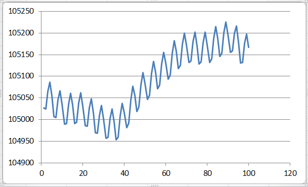

    5. I didn't notice when I first looked at the data, but when I zoomed into the plot, I noticed there is some periodic noise in the data. I believe this could be some sort of EMI pickup, which means that some shielding may help. If you look at the last 100 points of data, this is what it looks like:
    This could be from the reference side of the schematic, but it is more likely that this is the thermocouple picking up some EMI. Is this a long cable used to connect to the thermocouple? Is there a lot of ground noise, that might be picked up differently between positive and negative inputs?
    Joseph Wu

    The application of the customer is "thermocouple" and the length of "sensor - ADS1248" is around 5m (cable length is 5m), very long!
    Now the customer has been considering how to improve the noise issue.
