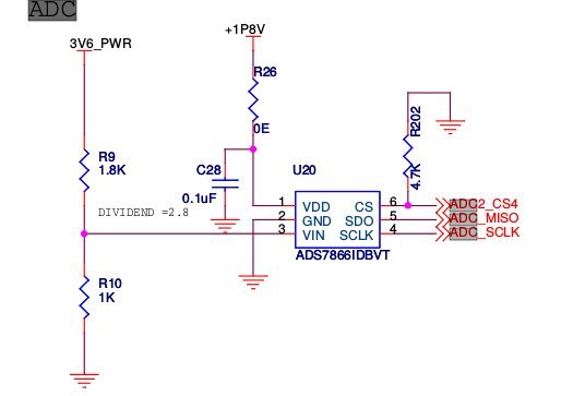

We have got ads7866 idbvt adc which we have connected to freescale's imx6Q processor through SPI. Now we are trying to get voltage(analog) value and display it. But it is giving Result is: 0 when we have connected 3.6V to respective Vin. Why is this so????? Please find our programs as attached

  • Hi SrinivasaRao,
    Thank you for your post. Can you please upload your screenshot by scope for SCLK/SDO and /CS signals here? It will be helpful to upload your schematic together, thanks.
    Dale
    Thanks for the reply...I have attached schemtic and will attach signals later  (once probing is done)... By the way is the programs and logic used is correct or not...
    I would like to the know the validity of programs (whether logic used is correct or not)????
  • Hi SrinivasaRao,
     Sorry modified, after checked your schematic and program:
    1. It needs 16 clocks to get the data, not 8 in the program.
    2. SPI should work at CPOL = 1, CPHA = 1 mode.
    3. ADS7866 can only support 200ksps sampling rate,I'm not sure 1MHz speed is your SCLK frequency or sampling rate in program, please check.
    4. VIN input should be driven with a low impedance source, if not, a buffer would help to achieve the rated performance of the converter.
    5. Because reference voltage is derived from the supply voltage internally, so a low noise/ripple and low impedance supply source is expected. A reference or buffered output can be used for power supply(more details can be refered to datasheet for this device or the family).
    It will be better to check the timing with screenshot for these SPI signals. Thanks.
