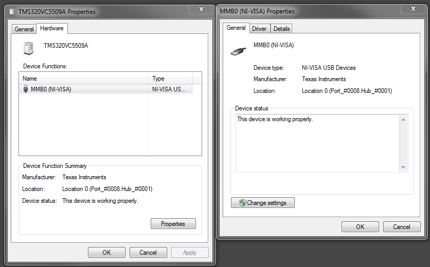

I recently bought an ADS1198ECGFE-PDK board (ADS1x98ECG FE Rev C – PWB Rev C and BOM Rev D; MMB0 Rev D) and I am having some issues with establishing communication to the board. I followed the user guide (Revised January 2016) setup steps:
  1. Verify the jumpers on the ADS1298ECG-FE are as shown in Figure 2 (note that these settings are the factory-configured settings for the board).
I verified the jumpers matched Figure 2 (see picture below).
  1. Verify that the jumpers on the MMB0 motherboard are configured as shown below:
  • MMB0 J13A -> Open
  • MMB0 13B -> Open
  • Refer to Section B.2 for details about the MMB0 power supply
I interpreted “Open” to mean remove the jumpers on MMB0 J13A and J13B. Jumpers were attached to those locations out of the box so I removed them.
  1. Install the ADS1298ECG-FE software using the latest software version. The latest software can be downloaded from the ADS1298ECG-FE product page or ADS1198ECG-FE product page. Double click the installer and follow the instruction to complete the software installation. For detailed installation information and screenshots, see Appendix C.
I installed ads1198ecg-fe-setup-1.1.1 from the Texas Instruments website on my desktop computer (Windows 7 Professional SP1 64-bit, Intel i5). The installation did not appear to have any issues. I plugged in the eval board and I did not get any new device detection pop-ups. Here is how it appeared in Device Manager:
I started up the ADS1198 software and got the following messages:
The libusb0.dll was in the C:/Windows/System32 folder but not in the C:/Windows/SysWOW64 folder. I copy-pasted the libusb0.dll to the 64-bit folder. This caused the libusb0.dll message to stop but the missing subVI messages stayed. In both cases, I got the same “Connection Failure” main screen.
What is recommended to troubleshoot these issues?

  • Hey Alan,
    Full disclosure, neither me nor my colleagues have encountered this issue before. To get this to work, it might require some trial and error, unfortunately. My best advice would be to try the following three things.
    First, have you uninstalled and re-installed the program? If not, it can't hurt.
    Second, do you see a *.log file in this directory: C:\Users\Public\Documents\ADS1198ECG
    Finally, do you have access to another PC?
    Sorry about this inconvenience!
    Brian
  • Brian:
    I am a trailblazer for bugs. :)
    1. Have you uninstalled and re-installed the program? If not, it can't hurt.
    - I have tried a few rounds of uninstalling and re-installing. The last cycle I uninstalled the TI software, all NI software, and the libusb driver and started from scratch. Same results.
    2. Do you see a *.log file in this directory: C:\Users\Public\Documents\ADS1198ECG?
    - I do not. The directory exists but is currently empty.
    3. Do you have access to another PC?
    - Yes, my co-worker installed the same software and used the same board and did not have a problem. He is also using a Windows 7/Intel computer.
    Alan
