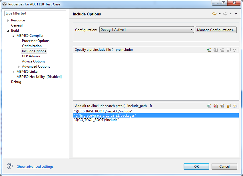

  • Hi pi314rules,
    It appears that when you created your empty project you used an 'Empty Grace (MSP430) Project' instead of the plain 'Empty Project.  I took your files and added them to a new Empty Project.  I copied the 'grace' and 'usr' folders to the project as well as main.c. In the include section of the main.c file make the following changes:
    #include <ti/mcu/msp430/Grace.h>
    #include "usr/UART_TxRx.h"
    #include "usr/ADS1118.h"
    #include "usr/LCD_driver.h"
    and in the main function change CSL_init() to Grace_init().
    You will also need to add to the project properties an include to the packages for the Grace configuration information.  It should appear similar to:
    Bob B
  • Hi Bob B,
    Thank you so much for your help! For the first time, the code successfully built, and I was able to send the program to my device by clicking Debug.
    The only remaining issue is that the temperature is not being displayed on the screen. I'm not sure if this is at all related to any of the changes you suggested. I have tried building the program a few times, pressing the reset button on the MSP430, and turning it off and on again. I did have to press "resume" in CCS, because the debug stopped the program at the Grace_init() line. I'm fairly certain that the program is running on the device, but I could be missing something.
  • Hi pi314rules,
    Glad to hear you are making some progress.  Up to this point I'm assuming that you are using the MSP-EXP430G2 Launchpad, am I correct?  Did you try running the ADS1118 BoosterPack with the supplied micro to make sure that everything was working?
    You must make sure that the jumpers at J5 are removed (P1.0 and P1.6) as this will directly affect communication to the LCD.  Also, for the software to download and debug properly the TXD and RXD jumpers on J3 must be set to SW UART position (up and down like the others on the connector).
    The final thing is the Grace file 'InterruptVectors_init.c' contains empty functions.  Go back to the original source code and compare the files and update as necessary.
    Information regarding the debugger is when the debug session starts the device is reset and stops at the first line of code in the main function.  This is normal and will stop at Grace_init() which is the first line in the function.
    Unfortunately I do not have the ADS1118 BoosterPack so I cannot verify that the build works as expected, but it should if you followed the above information.  If it does not, you will need to troubleshoot the communication and pin functionality.  One of the very first things in the code is setting up the LCD display and writing to it.  You can check and verify the communication with an oscilloscope or logic analyzer if you have one.
    Bob B
  • Hi Bob B,
    Apologies, I should have been clearer. Yes, I am using an MSP-EXP430G2 Launchpad, and the supplied micro (which I am assuming is the same thing as what I called the "demo program") worked fine.
    I did remove the J5 jumpers. Strangely enough though, the TXD and RXD jumpers have been in the HW UART position. Putting them the correct way did not change how the program ran (at least from what I saw).
    Copying the source code into 'InterruptVectors_init.c' from the original is what finally what made the temperature record onto the LCD screen. Problem officially solved!
