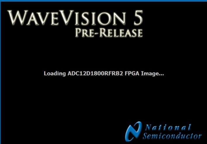

i have 3 pcs of ADC12D1800RFRB which i signed #1,#2,#3.  #1 was bought 2 years ago, and i can use it correctly following the < wavevision5 software User’s Guide.pdf >.
#2 and #3 was bought a few month ago . when i connect the #2 to WV5 with the same steps i used to #1, it appeared some errors:"a hardware error has occurred" and can't work.

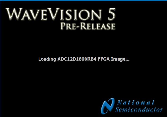

when i connect the #3 to WV5 with the same steps i used to #1, the board can be found by WV5, but when downloading the FPGA image , it appears "Loading ADC12D1800RB4 FPGA image" instead of " Loading ADC12D1800RFRB2 FPGA image ".
the PCB version of #1 is "PCB REV A", and which is "PCB REV B" to #2 and #3

1, i tested the beta version(5.0.6.465_HS12) of WV5 which Jim offered, #2 can be detected by the New version. but it appears"Loading ADC12D1800RB4 FPGA image" instead of " Loading ADC12D1800RFRB2 FPGA image ". why is ADC12D1800RB4 ? in the directory" ...\WaveVision5\hardware\fpga_images ",which one has be downloaded ?

  • Hi Jim
    Sorry for late reply, i have been on holiday for two weeks.
    i used the new vision of WV5 you offered to download the FPGA image, it seems succeed. but when it was downloading to my board(#1,#2,#3), it appears different message
    #1  Loading ADC12D1800RFRB2 FPGA Image...
    #2  Loading ADC12D1800RFRB4 FPGA Image...
    #3  Loading ADC12D1800RB4 FPGA Image...
    in the directory of WV5 (in my computer is "...\National Semiconductor\WaveVision5\hardware\fpga_images"), it has no " adc10d1000_xc4vlx25_adc12d1800rfrb4.bit"or" adc10d1000_xc4vlx25_adc12d1800rb4.bit ", so which image has been downloaded for my board #2 and #3 ?
