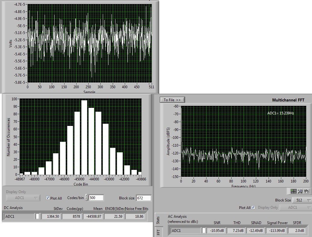

    OK - Would you be able to share your data (with inputs shorted), and perhaps the register settings as well, so I can try to replicate the issue with my ADS1263EVM?
    Something seems way off if your observing 20 uVrms, when the expected performance is 1.4 uVrms (for 400SPS, SINC1, PGA = 1V/V).
    I did a quick test with inputs shorted and observed about 1.6 uVrms noise (or 1364.5 codes StDev), as shown below:

    It must be something about our hardware wiring on the AIN pins because I still get the same results even with your settings, that is the only dfference now. The noise looks nothing like what you have. I am not having any luck pasting screen shots into the forum yet so I will describe below.

    dare I ask whether the noise was due to something particular to your setup or was there some general conclusion from which other systems might profit too in the future?
    Thank you very much
    Pio
  • Hi Pio,
    ADCPro was not displaying the data correctly and I think the noise performance was okay after all.
    Chris
