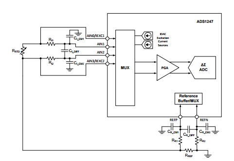

    that depends on your circuit implementation and ADC configuration. The following reference design shows one possible solution for a 3-wire RTD measurement system and describes how to calculate the RTD resistance.
    Please let us know in case this is not helpful and you would need further guidelines.
  • i am using the same design as you mentioned in your reply. i am also sending the pic of design in the attachment. my question is how to calculate the Temperature from the output of ADC (24 bit data) and also how to calculate RTD resistance from the output of ADC. i want the formula to calculate both.
  • Pattan,
    First you use the ADC to calculate the resistance of the RTD, then you use the resistance to get the temperature (either through a lookup table or by calculating it from an equation).
    To get the resistance value of the RTD, you must first use a precision resistor for the reference resistor RREF. Current flows from the excitation current sources to each lead of the RTD and then through the reference resistor. The output code of the ADC becomes:
    Output code = (RRTD*2^23)/(2*RREF)
    This assumes that the ADC PGA gain is 1. If the reference resistor is known and accurate, then you can calculate the equivalent resistance for the RTD. As an example, here is a lookup table for a PT100 RTD:

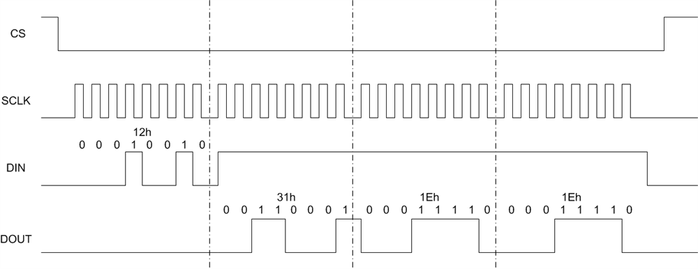

    To communicate with the ADS1248, the /CS is low to enable the SPI, SCLK dwells low and data is clocked in (or read) at the falling edge of the SCLK, MSB first. The example drawing I have here is using RDATA (12h) clocked into the device and then a series NOPs to clock out the data on DOUT. Here the example figure clocks out 311E1Eh as in the code example you mention in a previous post.
    Dotted lines separate the bytes, but in operation, bytes do not need to be separated to extra time.

  • Pattan,
    In general, this looks correct. I just want to point out a few things to remember.
    First, /CS should be low for the duration of the transaction. Second, The NOP transmission and the read data are the same 24 SCLKs. NOPs are used to clock out the data. Finally, data is clocked out MSB first.
    When implementing this system, I highly recommend using an oscilloscope or logic analyzer to look at the signals. It helps to see the actual digital transaction when trying to debug the code and nothing works.
    The diagram of the communication that I put in the last post is useful when you are able to see the digital communication.
