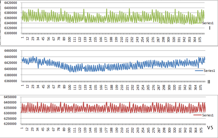

I am working on a project in which we have designed a board which contains CC2541 and multiple sensors interfaced to it via spi like temperature,accelerometer , ADS1293 and also a sd card for data logging.Currently device is supplied with the cc debugger only.
I have implemented 5 lead application for ADS129 and collected the data from the ads1293 by connecting 5 electrodes(RA,LA,LL,RL,V5) to the body  and entered this data in the excel sheet and plotted a graph and i got the graph as given in the below image.
Register settings:

Data Rate : 320 samples/sec
Cvref : Internal Reference voltage i.e. 2.4Volts.
The waveforms are not proper.I think there is lots of noise.What should i do to remove the noise?I have followed ti reference design while designing the circuit for ADS1293.
Also note that at every  1.5 sec i am stopping the data conversion as need to write the data into the sd card as soon data writing is completed i am restarting the conversion,if i don't  stop the conversion before writing into the sd card, the device fails to write data into the sd card.
please give your suggestion on this.
