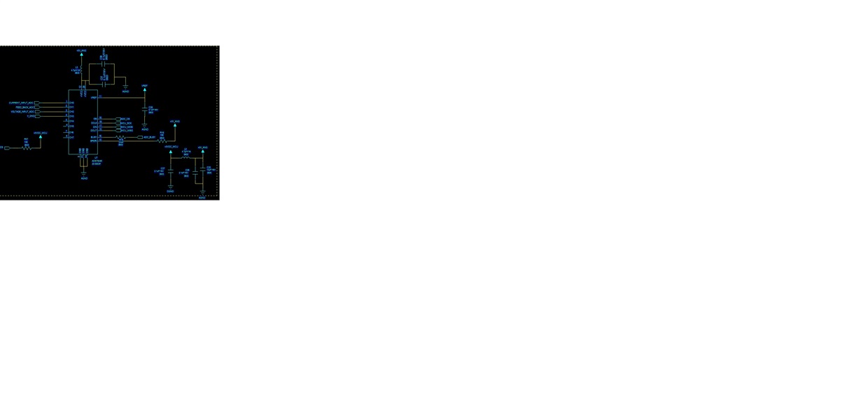

  • Hi shridhar
    Thank you for the reply. we interfaced ADS7844E with PIC Microcontroller through SPI. We are able to see the data reaching upto the ADC pin. we are writing 0x97 for the second channel but data we are getting is constant despite we varied through potentiometer.
    Please find the attachment and our code below.

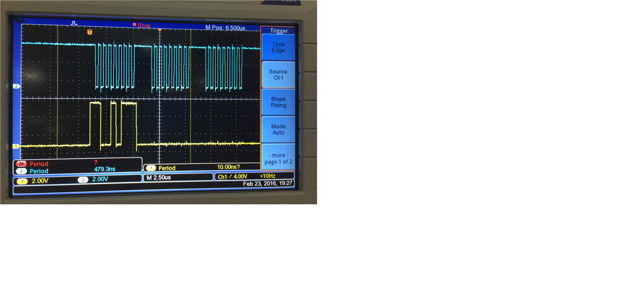

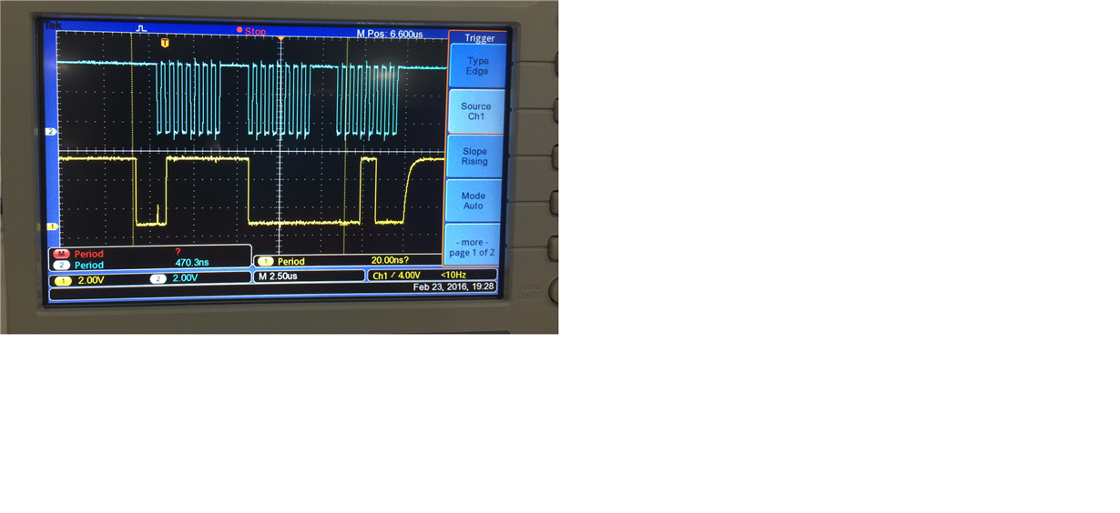

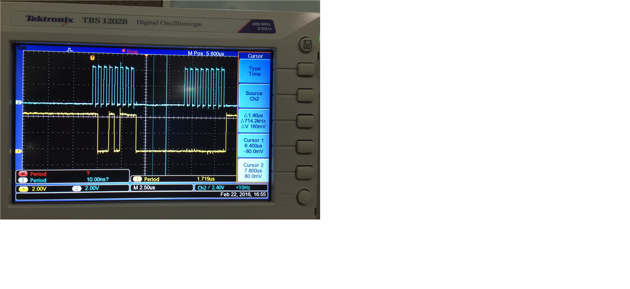

  •  hello shridhar
    Despite  change in frequency of DCLK from 5MHz to 1.7MHz still we are getting same frustrated results.please find the waveform below of both Data in and Data out.
  • Hello Shivakumar,
    Below are my observations from the waveforms shared & my comments regarding the same. Please correct if my observations are correct.
    1. I am assuming CS is held LOW for 3 bytes i.e. 24DCLK (1 byte for DIN programming & 2 bytes for data capture). I do not see the CS here & hence I assume that it is LOW when the SPI transaction is ongoing.
    2. The 1st image shows DCLK starting & ending in LOW state, while the 2nd image shows DCLK starting & ending in HIGH state. I do not know why these are different. Please confirm if CS is being pulled HIGH between device programming & data capture. If yes, can we avoid that.
    3. Please check if BUSY goes high after DIN 8th bit has been transmitted & goes LOW from the next DCLK.
    4. The device latches the information from DIN pin on the rising edge of DCLK. The DIN value should toggle at the falling edge of DCLK. The 1st image shows that the DIN data is toggling when DCLK is rising. This needs to match the device timing diagrams.
    5. Please confirm if the issue is observed across multiple devices of ADS7844.
    6. Please confirm the reference & power supply inputs are stable during the ADC conversion.
    Please make sure the digital interface is matching all the timing requirements or timing diagrams are met according to the datasheet.
    Thanks & Regards,
    Shridhar.

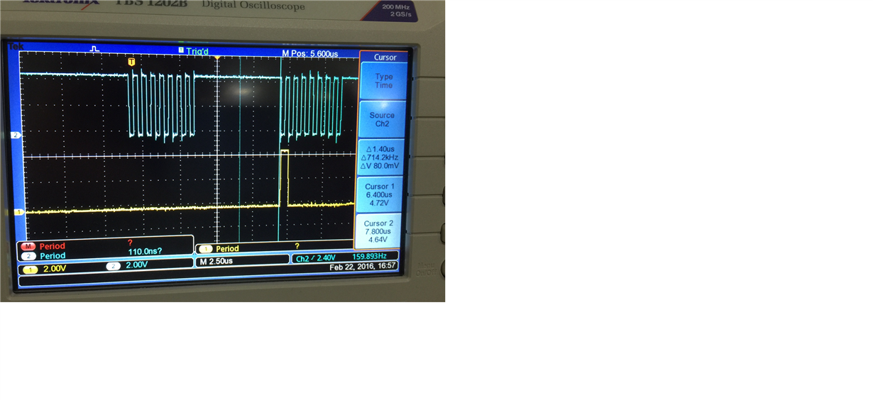

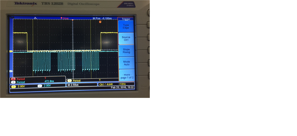

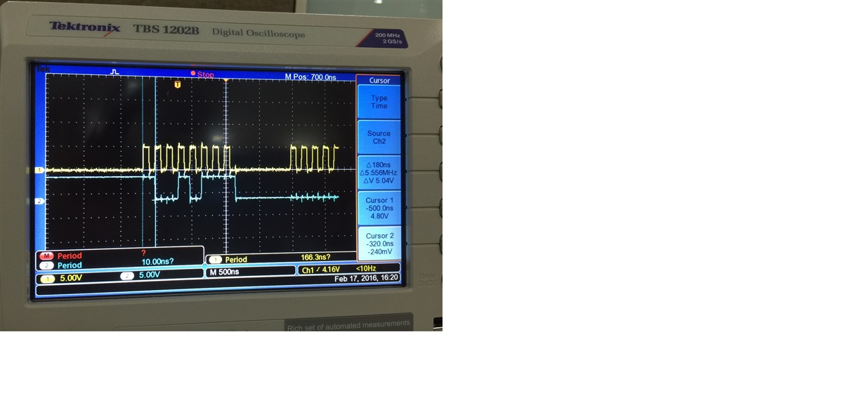

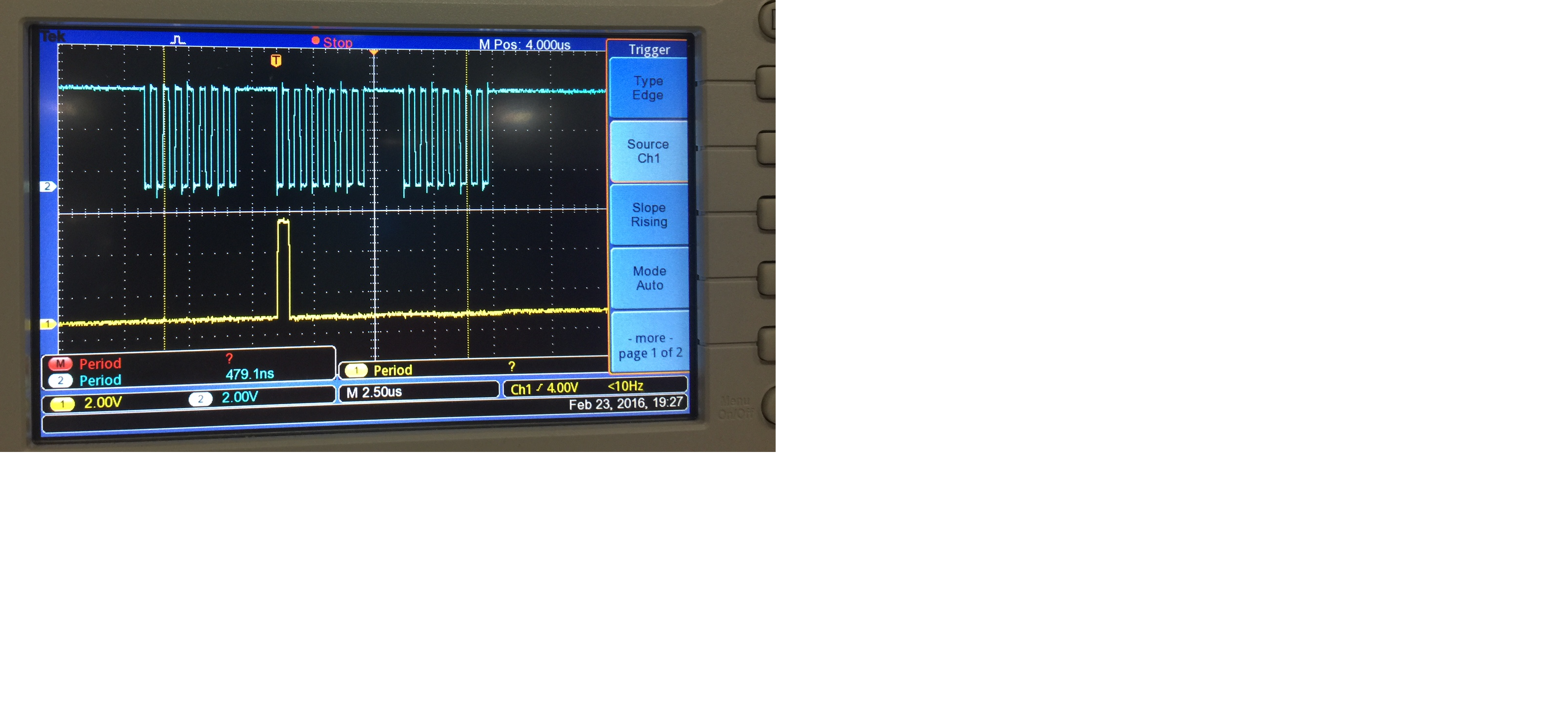

  • Hi shridhar
    Please find attachment our captured waveform
    1. chip-select with clock
    2. clock with data in with respect to ADC
    3. clock with busy with respect to ADC
    4 clock with Dout with respect to ADC
     https://e2e.ti.com/cfs-file/__key/communityserver-discussions-components-files/73/waveform.7z
  • Hi shridhar
    we noticed that data out from ADC is not changing(always constant) with respect to change in  input.
  • Hello Shivakumar,
    Based on the images shared the SPI mode used by the controller is CPOL = 1 & CPHA =1.
    The device ADS7844 works with CPOL = 0 & CPHA = 0 configuration i.e. DCLK should be LOW when CS pin goes LOW & the device latches the data on DCLK rising edge. Please refer figure 3 & 4 of the datasheet.
    Please change the mode setting for the controller SPI.
    Thanks & Regards,
    Shridhar.

  • Hello Shivakumar,
    After updating the SPI communication, the issue is resolved. Please reconfirm and I will close the communication.
    Thanks & Regards,
    Shridhar.
  • Hi shridhar
    after updating SPI it is now working fine.
