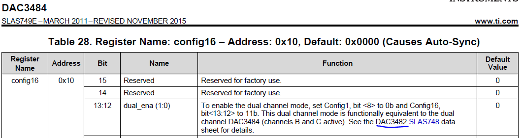

I have a question about the DAC3484.
In the datasheet, it mentions that in 2 channel mode, you should reference the DAC3482 datasheet for details:

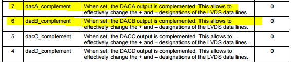

When referencing the DAC3482 datasheet, it states that when complementing the DACI and DACQ, bits 5 and 6 of config1 should be set. We have found this to be incorrect, and after some testing, flipping bits 6 and 7 instead have actually been shown to successfully control this complementing function. According to the datasheet however, bit 7 is supposed to be reserved:
Can you guys confirm? Also, if this is true, what is bit 5...reserved?

    I have confirmed the customer's finding and the next action is to correct the datasheet.
    Brief history:
    The DAC3482's I/Q path is operating on the same path of the DAC3484's digital channel A/B path. After the DAC3482's DSP path such as FIR and mixers, the final DAC digital data on I/Q path (or digital path AB) is send to the middle two DAC output core (DACI/DACQ or DAC_B/DAC_C of DAC3484 package). Since the complementing function is on the digital side, we should use bit 7 and bit 6 to complement the I/Q path (or A/B side)
    The register setting below is copied from the DAC3484 datasheet. You can see that the DAC3482's complementing function should be on bit 7 and bit 6 for path A and B DSP path complementing function. The original mistake on the DAC3482 datasheet is that the complementing function follows the analog core path of channel B/C output. This is a mistake and we will fix it. Our apologies.
