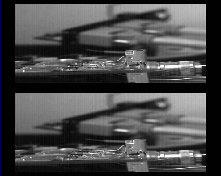

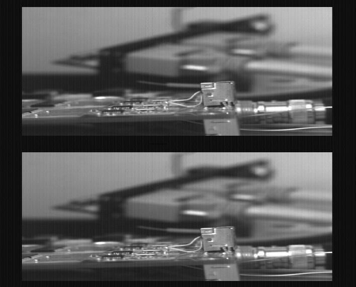

I am using the TVP5150AM1 serialized via a channellink chip in one of my companies products.  We've been using the TVP for a while with colour and monochrome NTSC cameras without any issues.  We now have some customers that are using PAL cameras.  Unfortunately, we're seeing a stripe pattern across the images.  While the distortion to the image isn't terrible it is very noticeable when compared to other receivers we've tested.  The first image below is the raw data captured from the TVP encoder before de-interlacing or resizing.  The second image is a Piccolo Alert analog frame grabber.
I've been trying to adjust different luminance and chrominance control registers in the TVP in the hopes of improving the image quality.  I haven't had any luck.  The status registers show that the TVP has detected a PAL camera with no colour subcarrier.  So this part is working correctly.  I've also forced a black output and received a perfect black image.  Our board layout matches the recommended layout for the TVP chip.  We do not have anti-aliasing filters on the inputs though.  I'll have the parts in a few days to test that but I'm doubtful that noise on the input is causing this issue.  Both colour and monochrome NTSC cameras work flawlessly with our setup.
If anyone has any suggestions for debugging the issue or additional insight to working with PAL cameras it would be very much appreciated.

    I have verified that this is happening with two separate monochrome PAL cameras.  Both cameras have been tested with different receivers to verify their output.  The other receivers did not exhibit the vertical striping.
    Also you'll notice in the images I've posted there is black padding around the image.  The camera that produced the images actually has a sensor that is smaller than PAL resolution.  The camera therefore pads its output.  If you look closely you can see that the striping is present even in the black padded areas added by the camera.  If the striping was caused by the camera's sensor I wouldn't expect the striping to be present in the black padded area.
    I'm doubtful that the issue is related to the cameras themselves.

  • One of the visual changes I've noticed is that the pixel values in the black padded area put out by the camera look significantly better if the automatic offset is disabled.  Writing 0x11 to register 0x01.  The first image below is with offset enabled and the second image is without.  The striping is still present but the pixel values are actually 0x01 for the black padded area as they should be.  With the offset enabled the black padded area will have pixel values from 0x0C to 0x14.
    Does this give you any ideas about what could potentially be causing the vertical striping?
