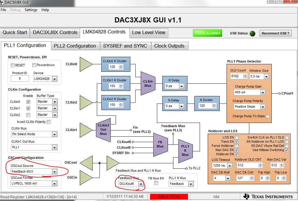

  • Gordon,
    If the TSW38J84 EVM is configured as "External Clock mode", the LMK04828 is operating as a clock distribution circuit. You will need to provide a reference clock that is equal to the DAC38J84's final DAC sample rate (device clock after interpolation stages).
    For instance, if the data rate for each input channel is 108MSPS, with 2x interpolation, the final DAC sample rate is 216MSPS. You will need to provide a 216MHz clock to the J17 connector.
    HSDC PRO input data rate should be set as 108MSPS (before interpolation). The interpolation is done at the DAC side. Picture below is from the DAC3xJ8x GUI, but the same applies to the TSW38J84 GUI.
    The TRF3722's reference input comes from the LMK04828's OSCOUT port. By default, the OSCOUT is a copy of the OSCIN, which is the 122.88MHz VCXO on the board. To set it to 108MHz, you may set the OSCOUT to output a copy from DCLKOUT6
    Be sure to set DCLKOUT6 to /2 mode to provide 216MHz/6 = 108MHz clock to the TRF3722.
