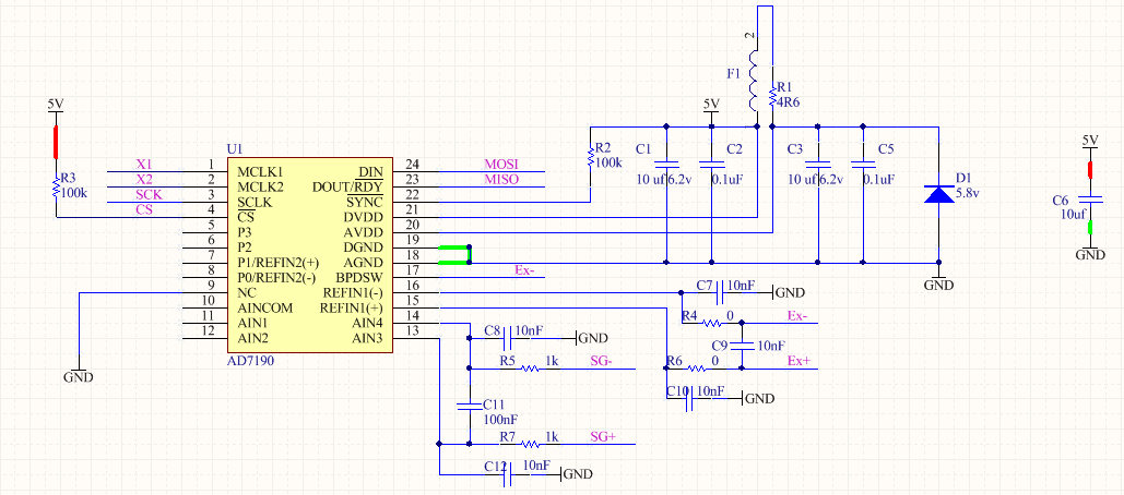

We are  using a 24 bit ADC (AD7190) for load cell transmitter .
it's working fine in our office .
but sometimes in factories it latched up .
This our schematic :
up to here maybe said this is not about TI .

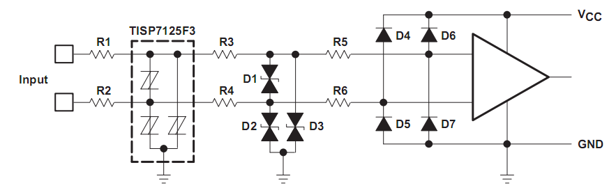

but as i read TI  Application Report SLYA014A - May 2000 ans see this part :
and try to apply this to our board .
when i add D1 (SMBj5CA) it hasn't affected  the ADC result .
but when i add D2 and D3 the adc behave nonlinear and have some more offset .!
i guess it's may happen because of leakage current .
Is there any specific schottky diode and TVS that you can recommend
that hasn't got these problem ?

    Generally, this forum is for Texas Instruments precision data converters. The AD7190 is an Analog Devices part. If you are having problems with it, I suggest that you contact them.
    However, one thing I noticed in your schematic is that you have an inductor going from the supply source to the digital supply pin. I would remove it and replace it with a short. Inductances in the power supply line can give you spikes in the voltage because of the digital currents. For each clock pulse, there is a high current, and this Ldi/dt can cause spikes. I've seen this disrupt operations in data converters, and I suspect this would be a problem with the AD7190 as well.

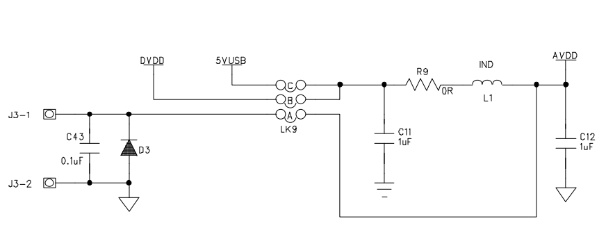

    I'm looking for appropriate schottky diode and tvs as protect against ESD .
    and about  inductor  actually this is a ferrite bead  and i have seen in AD7799 Evaluation board :

  • Mori,
    If you're looking for low leakage, I think the BAV199 has been suggested in the past as a low-leakage Schottky. For TVS devices, most are not low in leakage, and I don't really have any suggestions.
