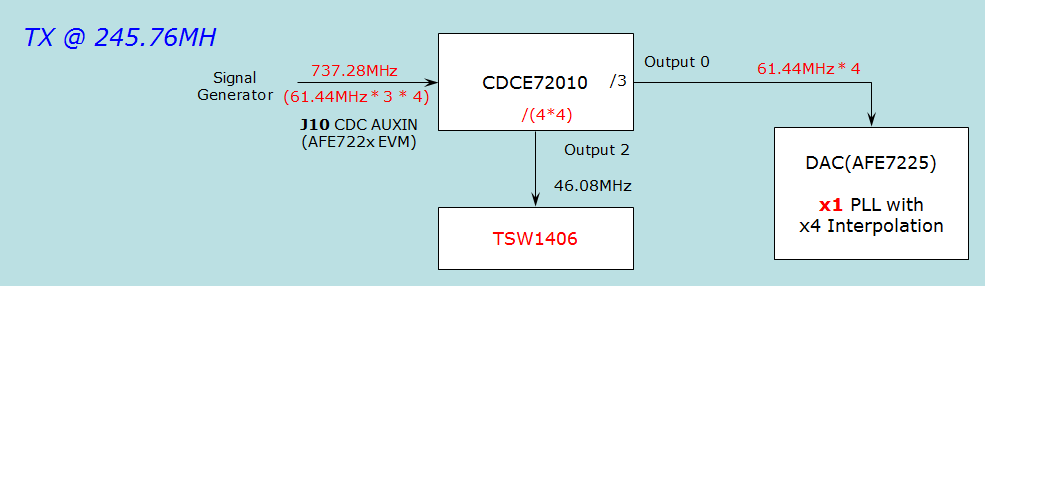

I have a afe7225 EVM and TSW1406 and want to test the DAC performance. the CDC AUX input is 368.64MHz, output 0 divider is 3, output 2 divider is 8. divideDAC clock is 1, interpolation is 4. test file is :WCDMA_TM1_complexIF30MHz_Fdata122.88MHz-1000.TSW. I got the signal on the spectrum analyzer at 7MHz and the bandwidth is 2MHz, and there is a lot of suprious on the spectrum. what's wrong with my configuration or test file?

    I believe the default interface is 2-wire DDR mode so change output 2 divider to 16.
    The input data rate for your current configuration is 30.72MHz. The WCDMA file you are using is 122.88MHz data rate so you cannot use this file.
    Eben.

    I designed the firmware of TSW1406 and it supports up to 500MHz to DAC interface. As TSW1406 is low cost version of pattern transmitter, there is a limit of pattern size which is 64K of I & Q samples due to internal DPRAM size. While TSW1400 has 1GB of external SDRAM onboard to load one frame size of LTE pattern, which helps to measure EVM (Error Vector Magnitude). Other than EVM measurement, general spectral measurement is ok with TSW1406.If you transmit full size of LTE pattern from HSDC Pro, the first 64K of I & Q samples shall be loaded into internal memory of FPGA and deliver this pattern to DAC. With this, you can measure spectrum without any problem.
    For AFE7225EVM settings, below is default settings. I suggest to create tone from HSDC Pro and measure it from spectrum analyzer to see the correct tone location first. Below is the setting for 245.76MHz of data rate for TX. You can refer to this and modify clocking based on your operation.

    I set the CDC AUX in to 737.28MHz, CDCE72010 output0 divider 3, output 2 divider 16, test file with WCDMA_TM1_ComplexIF30MHz_Fdata245.76MHz-1000.tsw.
    when I set X1 interpolation I can have 30MHz center frequency signal on spectrum analyzer, but the bandwidth is only 1.2MHz
    when I set X4 interpolation the center frequency is change to 7.5MHz, signal bandwdth is still 1.2MHz.
    is there something wrong of it?

  • Hi, David
    The clock diagram above is for x4 of interpolation case and sampling clock is 245.76MHz for DAC. In this case, the input data rate should be 61.44MHz (=245.76MHz/4). So the data rate from HSDC Pro should be 61.44M.
    For x1 interpolation, you should change clock scheme.
    For x4 interpolation with 245.76MHz of test pattern, I expect you'll get this result (7.5MHz (=30M/4) located with 1.25MHz (5MHz/4).
    KW

  • Hi, David
    You can download pattern generator from TI website (TSW1400EVM). The name of SW is "Software for creating High Speed DAC Pattern" and you can create 61.44MHz of sample rate. In general, 61.44MHz of input rate with x4 interpolation is more standardized architecture rather than 245.76MHz of input rate with x1 interpolation. You can set /4 from output 2 for x1 interpolation.
