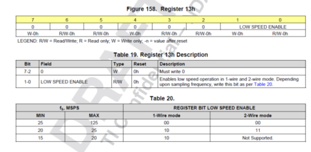

We're using an ADC3243 to sample at several low frequencies.  Operation is correct at the following frequencies: 60.0 MHz, 30.975 MHz, 25 MHz, and 20.265 MHz.  However, when attempting to operate at 12.159 MHz, the output FCLK is no longer a square wave.  It is still periodic, but it not the correct frequency and has short, positive pulses where it should be low.  DCLK does not look correct either.
Below is a register dump when this condition occurs.  The input clock is good quality and the correct frequency, and all other frequencies listed above work correctly.  The datasheet indicates that sampling is supported down to 10 MSPS.  Any idea what needs to be changed or if sampling down to 10 MSPS is actually supported?

  • Dallas,
    We are making some datasheet updates for this family.  One of them is an update on the minimum sampling speed of the converter.  After extensive testing with a larger number of devices, the min spec is being set to 15Msps.  This can be achieved with a low speed setting using register x13h in 1 wire mode only.
    10Msps may work, but across a statistical number of units we can only spec a min of 15Msps.
    Ken.
  • Got it. Thanks for the info. I believe that explains what I'm seeing.
