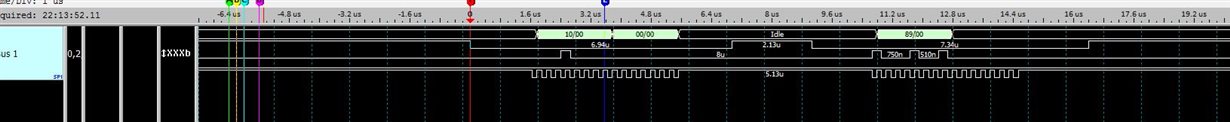

LMP90078 with internal clock only, SPI Fail to RW
Other Parts Discussed in Thread: LMP90078, LMP90100
  Can I use LMP90078 without external clock ?
Now I can not communicate with it through SPI.
Following is my timing chart from LA.
What's the problem could be ?
Thank you~
I write INS 1 = 0x10 0x00 and INS 2 = 0x89 0xXX to read a address 0x09 register.
But there is always no response.
  • The LMP90100 requires an external crystal or a clock signal from an external source in the system. For programing guide please refer to the application note SNAA075A (AN-2181 Microcontroller Firmware Considerations for National LMP90100 Sensor AFE) at the following link.
