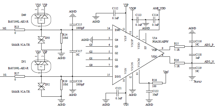

The chip ADS1278 was used in our product for data aqquisition. Since the prototye design stage(about 20pcs), there are several ICs functioning abnormally, mostly one channel not working properly. The collected data of this channel is of full scale 3V(VREF 3v), test condition is floating differential input(each pin is 10MΩ resistor paralleled to GND) of pre-amplifier. Normally the data is of small amplitude around ground level. Pre-amplifier IS is PGA281.

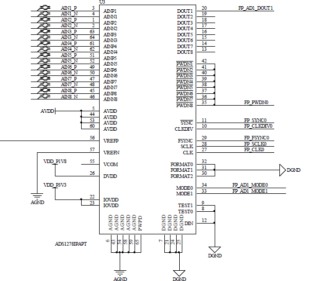

    Thanks for your reply. The schematic is as follows(ADS1278 and PGA281), REFP of ADS1278 is connected from IC ADR443BR(3v voltage ref), not presented in the schematic. ADS1278 is controlled by FPGA chip.

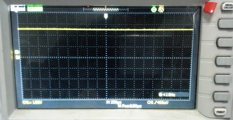

    Please take a note that  Vref of PGA281 is with another 2.5V voltage ref. Possibly It may cause bad result. The captured waveform(dc coupled, 1V/vertical, 250us/horizontal) at input + of first channel of ADS1278 is as below, same as othe seven channels.

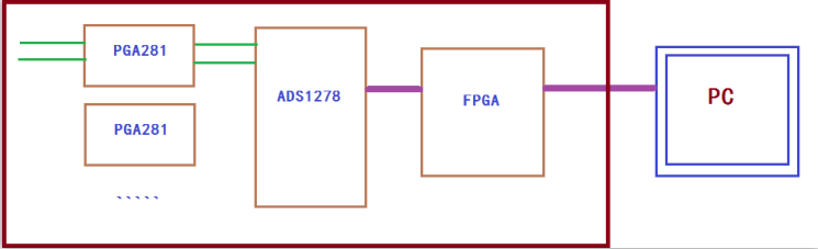

    The problem is only with 3 or 4 boards, not all prototype. The 3v full scale amplitude of abnormal channel is not captured by scope, but read out from FPGA program(output to PC through RS232). The simple block diagram as below:

    The VOCM pin of the PGA281 sets the output common-mode voltage. This means that the output signals on both VOP and VON will be centered around VOCM, which is 2.5V in your application. Therefore, I expect AIN1P to look like the scope capture you are showing.
    I'm not sure I understand the problem. For the channels that are "failing," what is the measured output voltage of the PGA281 and what is the output of the ADS1278 for those channels?
