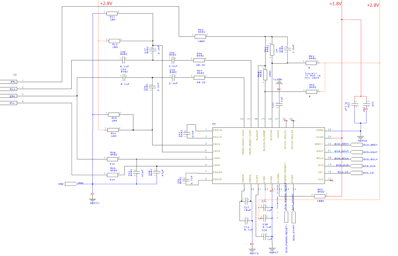

I am trying to interface ADS1292r with STM32L151rd ARM processor via SPI (32MHz system clock, 1MHz SPI clock). Following ADS1292RECG-FE, the design circuit stands:

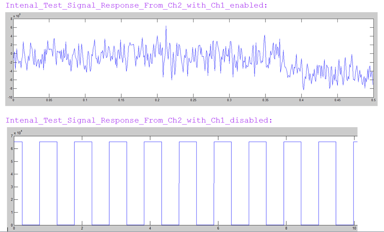

From channel 1, MCU can read internal 1Hz test signal well, also external signal (10mVpp) provided from signal generator.
But, for channel 2, clean output for internal 1Hz test signal only when channel 1 is disabled. Also, irregular/ noisy channel 2 when external signal (10mVpp) applied from signal generator.
LA, LL electrodes are also shorted following sample circuit provided in ADS1292 datasheet. Still noisy. What could be the reason for that ? Do I need to modify circuitry for channel 2 ?
With the following configuration, I'm finding noisy waveform across PGA2P and PGA2N pins via oscilloscope.

    Welcome to the e2e forum!  I see you managed to post the same thing twice, so I'm going to delete the second instance.  Can you try shorting channel 2 at the chip, and then move out to your electrodes (short the inputs at R38/R39 on the chip side, and then on the electrode side...) and see if that makes any difference?

    I'm working with a custom build PCB. Are you suggesting for input short test for channel 2 (001 to MUX2[3:0] and shorting LL and RA of my design?). I found a fixed output value for that around 65400.
    I request to know any other way to check. I tried to connect chest electrodes directly to RA, LL connectors and also found noises.

    When there is 'noise' in the output data of an ADC, the easiest way to track down where it might be coming from is to short the inputs at various stages of the analog input signal chain to see where it might be coming from. So starting right at the chip, short the inputs and look at the data. If it's clean, move backwards down the signal chain untill you get to the end of the line - the electrodes in this case.

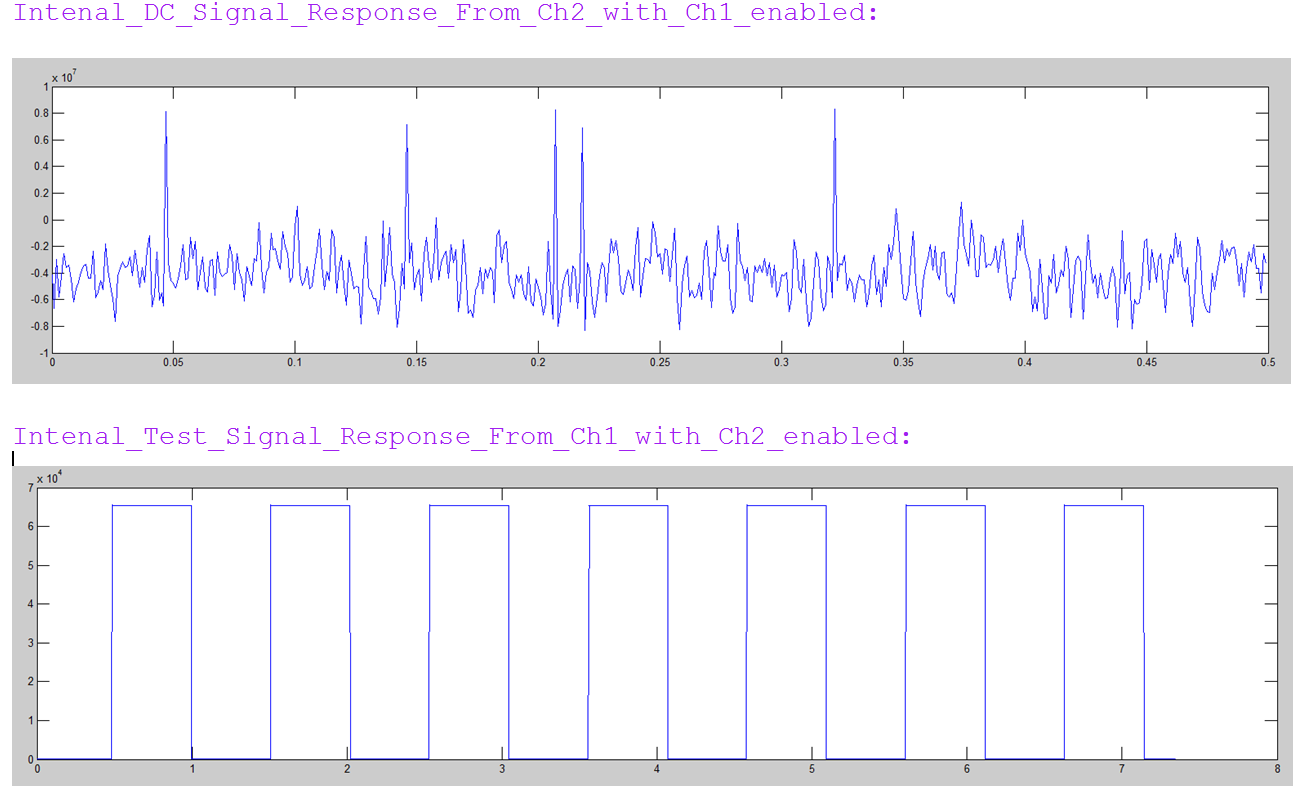

    I've checked external circuitry. I'm wondering what could be the reason for this behavior of Channel 2 : When channel 1 is enabled, internal 1Hz test signal and input short test do not work for Channel 2. Works only when Channel 1 is disabled (0x80 to 0x04 register). No such problem for Channel 1.

    Have you tried this test with another board or another chip?  I can't think of any reason why the internal test signals should be corrupted on CH2 only if CH1 is enabled.  Screen shots of what you are seeing would be helpful.
    With sample rate 1Kbps, respiration disabled and Test signal (0xA3 to 0x02 register and 0x05 to 0x04 for ch1 and 0x05 to 0x05 register for ch2), this is the result: X-axis (Sec), Y-axis (Count Values).
     Internal_DC_Signal_Response_From_Ch2_with_Ch1_disabled: count value 65451
    (Channel disabled by sending 0x80)
     To convert count values to voltage: is the scale factor: 0.000047683?
    (Scale_factor= (Vref/gain)/(2^23-1)= (2400/6)/8388607= 0.000047683 mV)
    Then this amplitude becomes 3.12 mv !!
    Other responses:
