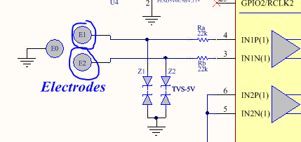

We are using the ADS1291 as a surface EMG amplifier. We are powering with 3.3V and have -1.5V and 1.5V as the analog supplies. We are using the device in single shot mode. Right now, if either of the differential inputs (IN1N and IN1P) are shorted to ground, the signal goes to ground. However, if we short the two pins to each other, the signal does not become 0 (no 0 differential).
Do you have any ideas on what might be causing this? Hardware? Software?
